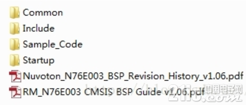

三、N76E003_BSP_Keil_C51_V1.0.6.zip
文件说明
