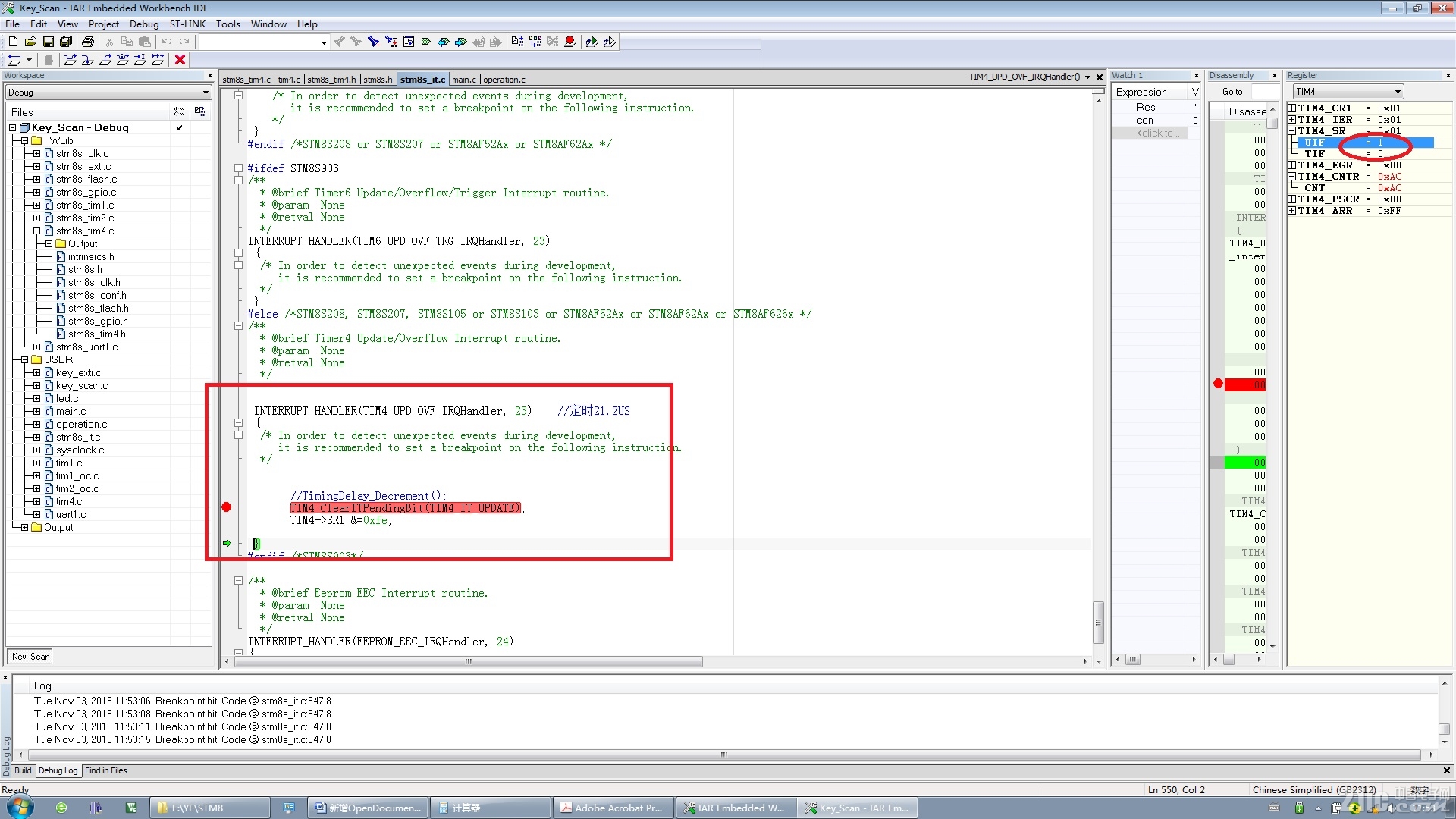

用STM8S003进入TIM4中断后不能对UIF清0,死循环在TIM4中断里面,请高手来解决。。谢谢。
void TIM4_Configuration(void)
   TIM4_TimeBaseInit(TIM4_PRESCALER_128 ,200);   //煦128   RES=200
   TIM4_ARRPreloadConfig(ENABLE);         //赻雄蚾婥妏夔
   TIM4_PrescalerConfig(TIM4_PRESCALER_128,TIM4_PSCRELOADMODE_IMMEDIATE);
   TIM4_SetAutoreload(200);
   TIM4_Cmd(ENABLE);   //數杅妏夔
   TIM4_ITConfig(TIM4_IT_UPDATE,ENABLE);    //笢剿羲宎
  TIM4->IER=0x00;//輦砦笢剿
  TIM4->EGR=0X01;//埰勍奀夔載陔岈璃
  TIM4->PSCR=0x07;// 數杅奀笘=翋奀笘/128=16MHZ/128=125KHZ=8us
  TIM4->ARR=51;//赻雄蚾婥硉˙隅奀笚=8us*51=408us
  TIM4->CNTR=51;//數杅場硉
  TIM4->CR1=0x01;//奀夔數杅
INTERRUPT_HANDLER(TIM4_UPD_OVF_IRQHandler, 23)    //隅奀21.2US
  /* In order to detect unexpected events during development,
     it is recommended to set a breakpoint on the following instruction.
       //TimingDelay_Decrement();
       TIM4_ClearITPendingBit(TIM4_IT_UPDATE);
       TIM4->SR1 &=0xfe;
int main(void)
        /* 扢离俋窒16M儒淥峈炵苀翋奀笘 */
        SystemClock_Init(HSE_Clock);
        Key_Init();
        LED_Init();
        Tim1_Init();     //PC1~4岆PWM 怀堤
        TIM4_Configuration();
        enableInterrupts();        /* 羲軞笢剿 */
        while (1)
           Operation();
