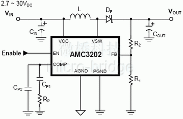

AMC3202
AMC3202--1.5A 280kHz Boost DC-DC Converter
Features
﹡Integrated Power Switch: 1.5A Guaranteed.
﹡Wide Input Range: 2.7V to 30V.
﹡40V Power Switch Input Voltage.
﹡High Frequency Allows for Small Components.
﹡Minimum External Components.
﹡Built in Over Current Protection.
Applications
﹡Electronic Information Organizers
﹡Palmtops
﹡Cellular and portable phones
﹡Various Multi-function Power Supplies
﹡TFT-LCD Power Management
﹡LCD Monitor/TV LED Backlight Driver
0755-83991588 sales@micro-bridge.com
相关链接:http://www.micro-bridge.com/AMC3202.asp
