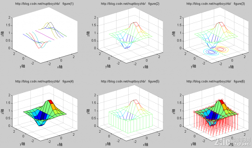

 楼主| gaoyang9992006 发表于 2017-6-22 16:29 | 显示全部楼层 |阅读模式
1.画函数的三维图,如:Z(X,Y)=2*X.*exp(-X.^2-Y.^2)+1;
  1. close all;
  2. [X,Y]=meshgrid(-2:0.5:2,-2:0.5:2);%生成坐标轴
  3. Z=2*X.*exp(-X.^2-Y.^2)+1;%Z是X,Y的函数
  4. %%%%%%%%%%%%%%%%%%%%%%%%%%%%%%%%%%%%%%%%%%%%%%%%%%%%%%%%%%%%%%%
  5. num=0;
  6. num=num+1;
  7. subplot(2,3,num);
  8. plot3(X,Y,Z);
  9. axis([-3 3 -3 3 0 2]);%限定显示的范围
  10. xlabel('x轴');%x轴坐标
  11. ylabel('y轴');%y轴坐标
  12. zlabel('z轴');%z轴坐标
  13. title('http://blog.csdn.net/nuptboyzhb/   figure(1)');%标题
  14. %%%%%%%%%%%%%%%%%%%%%%%%%%%%%%%%%%%%%%%%%%%%%%%%%%%%%%%%%%%%%%%
  15. num=num+1;
  16. subplot(2,3,num);
  17. mesh(X,Y,Z);
  18. axis([-3 3 -3 3 0 2]);%限定显示的范围
  19. xlabel('x轴');%x轴坐标
  20. ylabel('y轴');%y轴坐标
  21. zlabel('z轴');%z轴坐标
  22. title('http://blog.csdn.net/nuptboyzhb/   figure(2)');%标题
  23. %%%%%%%%%%%%%%%%%%%%%%%%%%%%%%%%%%%%%%%%%%%%%%%%%%%%%%%%%%%%%%%
  24. num=num+1;
  25. subplot(2,3,num);
  26. meshc(X,Y,Z);
  27. axis([-3 3 -3 3 0 2]);%限定显示的范围
  28. xlabel('x轴');%x轴坐标
  29. ylabel('y轴');%y轴坐标
  30. zlabel('z轴');%z轴坐标
  31. title('http://blog.csdn.net/nuptboyzhb/   figure(3)');%标题
  32. %%%%%%%%%%%%%%%%%%%%%%%%%%%%%%%%%%%%%%%%%%%%%%%%%%%%%%%%%%%%%%%
  33. num=num+1;
  34. subplot(2,3,num);
  35. surf(X,Y,Z);
  36. axis([-3 3 -3 3 0 2]);%限定显示的范围
  37. xlabel('x轴');%x轴坐标
  38. ylabel('y轴');%y轴坐标
  39. zlabel('z轴');%z轴坐标
  40. title('http://blog.csdn.net/nuptboyzhb/   figure(4)');%标题
  41. %%%%%%%%%%%%%%%%%%%%%%%%%%%%%%%%%%%%%%%%%%%%%%%%%%%%%%%%%%%%%%%
  42. num=num+1;
  43. subplot(2,3,num);
  44. meshz(X,Y,Z);
  45. axis([-3 3 -3 3 0 2]);%限定显示的范围
  46. xlabel('x轴');%x轴坐标
  47. ylabel('y轴');%y轴坐标
  48. zlabel('z轴');%z轴坐标
  49. title('http://blog.csdn.net/nuptboyzhb/   figure(5)');%标题
  50. %%%%%%%%%%%%%%%%%%%%%%%%%%%%%%%%%%%%%%%%%%%%%%%%%%%%%%%%%%%%%%%
  51. num=num+1;
  52. subplot(2,3,num);
  53. surf(X,Y,Z);
  54. hold on;
  55. stem3(X,Y,Z,'r');%画竖线
  56. axis([-3 3 -3 3 0 2]);%限定显示的范围
  57. xlabel('x轴');%x轴坐标
  58. ylabel('y轴');%y轴坐标
  59. zlabel('z轴');%z轴坐标
  60. title('http://blog.csdn.net/nuptboyzhb/   figure(6)');%标题

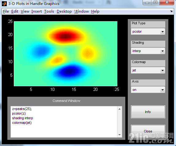

另外,在\matlab*****\toolbox\matlab\demos\graf3d.m中文件,有更加详细的介绍。界面如下:
