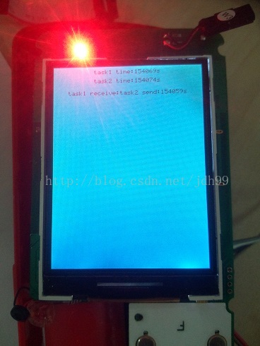

环境:
主机:WIN8
开发环境:MDK4.72
ucgui版本:3.90
ucos版本:ucos-ii
mcu: stm32f103VE
说明:
本示例中task1通过邮箱发送数据给task2
效果图:
源码:
  • #define TASK_STK_SIZE                512
  • *                                                        静态函数
  • static void task_start(void *pdata);
  • static void task1(void *pdata);
  • static void task2(void *pdata);
  • *                                                        静态变量
  • *                                                        任务堆栈空间
  • static OS_STK Task_Start_Stk[TASK_STK_SIZE];
  • static OS_STK Task1_Stk[TASK_STK_SIZE];
  • static OS_STK Task2_Stk[TASK_STK_SIZE];
  • *                                                        信号量
  • OS_EVENT *Semaphore;
  • *                                                        函数
  • int main(void)
  •         //初始化内核
  •         OSInit();
  •         //创建任务
  •         OSTaskCreate(task_start,(void *)0,Task_Start_Stk + TASK_STK_SIZE - 1,10);
  •         //启动任务
  •         OSStart();
  • *                                                        任务函数
  •         //载入世界
  •         world_load();
  •         //设置背景色
  •         GUI_SetBkColor(0xb07c17);
  •         GUI_Clear();
  •         GUI_SetColor(GUI_BLACK);
  •         Semaphore = OSMboxCreate((void *)0);
  •         //新建任务
  •         OSTaskCreate(task1,(void *)0,Task1_Stk + TASK_STK_SIZE - 1,11);
  •         OSTaskCreate(task2,(void *)0,Task2_Stk + TASK_STK_SIZE - 1,12);
  •         while(1)
  •                 OSTimeDlyHMSM(0,0,3,0);
  •         char str[30] = {0};
  •         uint8_t err = 0;
  •         char *mail;
  •         while(1)
  •                 //请求信号量
  •                 mail = OSMboxPend(Semaphore,0,&err);
  •                 //显示
  •                 sprintf(str,"task1 receive:%s",mail);
  •                 GUI_DispStringHCenterAt(str, 120, 40);
  •                 //显示
  •                 sprintf(str,"task1 time:%ds",OSTimeGet());
  •                 GUI_DispStringHCenterAt(str, 120, 5);
  •                 WM_Exec();
  •                 OSTimeDlyHMSM(0,0,1,0);
  •         uint8_t err = 0;
  •         while(1)
  •                 //显示
  •                 sprintf(str,"task2 send:%ds",OSTimeGet());
  •                 //发送信号量
  •                 OSMboxPost(Semaphore,str);
  •                 //显示
  •                 sprintf(str,"task2 time:%ds",OSTimeGet());
  •                 GUI_DispStringHCenterAt(str, 120, 20);
  •                 WM_Exec();
