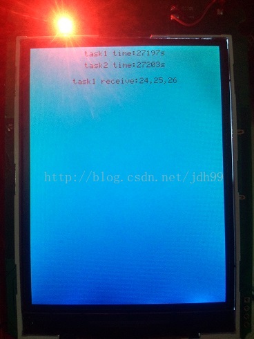

本示例中task2请求内存分区,然后往分区内写数据,再将数据通过邮箱发送给task1
效果图:
源码:

  •         Semaphore = OSMboxCreate((void *)0);
  •         //创建内存分区
  •         Buffer_Ptr = OSMemCreate(Buffer,10,30,&err);
  •         //新建任务
  •         OSTaskCreate(task1,(void *)0,Task1_Stk + TASK_STK_SIZE - 1,11);
  •         OSTaskCreate(task2,(void *)0,Task2_Stk + TASK_STK_SIZE - 1,12);
  •         while(1)
  •                 OSTimeDlyHMSM(0,0,3,0);
  • static void task1(void *pdata)
  •         char str[30] = {0};
  •         uint8_t err = 0;
  •         uint8_t *mail;
  •         while(1)
  •                 //请求信号量
  •                 mail = OSMboxPend(Semaphore,0,&err);
  •                 //显示
  •                 sprintf(str,"task1 receive:%d,%d,%d",mail[0],mail[1],mail[2]);
  •                 GUI_DispStringHCenterAt(str, 120, 40);
  •                 //显示
  •                 sprintf(str,"task1 time:%ds",OSTimeGet());
  •                 GUI_DispStringHCenterAt(str, 120, 5);
  •                 WM_Exec();
  •                 OSTimeDlyHMSM(0,0,1,0);
  • static void task2(void *pdata)
  •         uint8_t err = 0;
  •         uint8_t *ptr;
  •         static uint8_t a = 0;
  •         while(1)
  •                 //请求内存分区
  •                 ptr = OSMemGet(Buffer_Ptr,&err);
  •                 //赋值
  •                 ptr[0] = a++;
  •                 ptr[1] = a++;
  •                 ptr[2] = a++;
  •                 //用邮箱发送
  •                 OSMboxPost(Semaphore,ptr);
  •                 //释放内存分区
  •                 OSMemPut(Buffer_Ptr,ptr);
  •                 //显示
  •                 sprintf(str,"task2 time:%ds",OSTimeGet());
  •                 GUI_DispStringHCenterAt(str, 120, 20);
  •                 WM_Exec();
