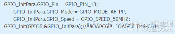

本人使用GD32F207VC开发板无法输出互补PWM波形。程序使用高级定时器时钟1,将PA8和PB11设为互补PWM输出引脚。具体程序如下。请各位帮我看一下。谢谢!程序编译无措。
#include "gd32f20x.h"
#include <stdio.h>
#include "systick.h"
int compare ;
void TIM8_init()
  TIMER_BaseInitPara tim1_int;// ʱÖÓ1³õʼ»¯
        TIMER_BKDTInitPara tim1_DT; //ʱÖÓ1ËÀÇøÊ±¼ä
        TIMER_OCInitPara   tim1_OC; // ʱÖÓ1ͨµÀÉèÖÃ
  tim1_int.TIMER_Period = 1200;// 120Mʱ¿ª¹ØÆµÂÊ100k
        tim1_int.TIMER_Prescaler = 0;//¶¨Ê±Æ÷ʱÖÓΪ120M
  tim1_int.TIMER_ClockDivision = TIMER_CDIV_DIV1;//¶¨Ê±Æ÷ʱÖÓΪ120M
        tim1_int.TIMER_CounterMode = TIMER_COUNTER_UP;//ÏòÉϼÆÊý
        TIMER_BaseInit(TIMER1,&tim1_int);
        //ÅäÖÃËÀÇøÊ±¼ä  ËÀÇøÎª0.1us
  tim1_DT.TIMER_ROSState = TIMER_ROS_STATE_ENABLE;
        tim1_DT.TIMER_IOSState = TIMER_IOS_STATE_ENABLE;
        tim1_DT.TIMER_LOCKLevel = TIMER_LOCK_LEVEL_OFF;
        tim1_DT.TIMER_DeadTime = 12;
        tim1_DT.TIMER_Break = TIMER_BREAK_DISABLE;
        tim1_DT.TIMER_BreakPolarity = TIMER_BREAK_POLARITY_LOW;
        tim1_DT.TIMER_OutAuto = TIMER_OUTAUTO_DISABLE ;
  TIMER_BKDTConfig(TIMER1,&tim1_DT);
        //ÉèÖÃͨµÀ1£¬Í¨µÀ1N
        tim1_OC.TIMER_OCMode = TIMER_OC_MODE_PWM1;//¼ÆÊýֵСÓÚÉ趨ֵΪÓÐЧµçƽ
        tim1_OC.TIMER_OutputState = TIMER_OUTPUT_STATE_ENABLE;//Êä³ö±È½ÏʹÄÜ
        tim1_OC.TIMER_OutputNState = TIMER_OUTPUTN_STATE_ENABLE;//Êä³ö±È½Ï·´ÏòʹÄÜ
        tim1_OC.TIMER_Pulse = compare;//±È½ÏÖµ
        tim1_OC.TIMER_OCPolarity = TIMER_OC_POLARITY_HIGH;//ÓÐЧµçƽΪ¸ßµçƽ
        tim1_OC.TIMER_OCNPolarity = TIMER_OCN_POLARITY_HIGH;//ÓÐЧµçƽΪ¸ßµçƽ
        tim1_OC.TIMER_OCIdleState = TIMER_OC_IDLE_STATE_SET;//¿ÕÏÐʱÒý½Å״̬
        tim1_OC.TIMER_OCNIdleState = TIMER_OCN_IDLE_STATE_RESET;//¿ÕÏÐʱÒý½Å×´
  TIMER_OC1_Init(TIMER1,&tim1_OC);
        TIMER_OC1_Preload(TIMER1,TIMER_OC_PRELOAD_ENABLE);//×Ô¶¯×°ÔØÊ¹ÄÜ
  TIMER_Enable(TIMER1,ENABLE);
        TIMER_CtrlPWMOutputs(TIMER1,ENABLE);//¿ªÆôON£¬OCÊä³ö£¨BDTR£©
//        TIMER_CC_PreloadControl(TIMER1,ENABLE);
void  PWM_GPIO_init()
  GPIO_InitPara GPIO_InitPara;
        RCC_APB2PeriphClock_Enable(RCC_APB2PERIPH_TIMER1,ENABLE);
        RCC_APB2PeriphClock_Enable(RCC_APB2PERIPH_GPIOA | RCC_APB2PERIPH_GPIOB, ENABLE);
        GPIO_InitPara.GPIO_Pin = GPIO_PIN_8;
        GPIO_InitPara.GPIO_Mode = GPIO_MODE_AF_PP;
        GPIO_InitPara.GPIO_Speed = GPIO_SPEED_50MHZ;
        GPIO_Init(GPIOA,&GPIO_InitPara);//ÅäÖÃPA7Ϊ¸´ÓÃÍÆÍì TM8-CH1N
  GPIO_InitPara.GPIO_Pin = GPIO_PIN_13;
  GPIO_Init(GPIOB,&GPIO_InitPara);//ÅäÖÃPC6Ϊ¸´ÓÃÍÆÍì TM8-CH1
int main(void)
        compare = 800;
        TIM8_init();
        PWM_GPIO_init();
        while(1)
    compare = 800;
                TIMER_Compare1Config(TIMER1,compare);

PA8是TM1的1通道啊。程序用的是PB13,上面文字写错了。PB13是TM1的1N通道啊。有什么设置问题吗?谢谢!

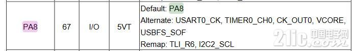

chenyilin 发表于 2018-11-16 10:20 | 显示全部楼层
xiaobai032 发表于 2018-11-15 21:02
是PB13,不是PB11.PB13是CH1N
您好,您可以到官网上下载最新的关于207的datasheet,上面有做标明,
如果您使用的是TIM1 那么修改为timer 0 试试。
 楼主| xiaobai032 发表于 2018-11-16 20:41 | 显示全部楼层
您好,我用的是跟板子一起提供的库函数。库函数中时钟只有1到14.没有时钟0.那应该怎么办。你提供的图应该时钟编号为0-13.与我的库函数不符?怎么办?改为timer0直接报错。

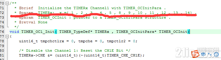

这是测试PA8 -PB13引脚的波形图
