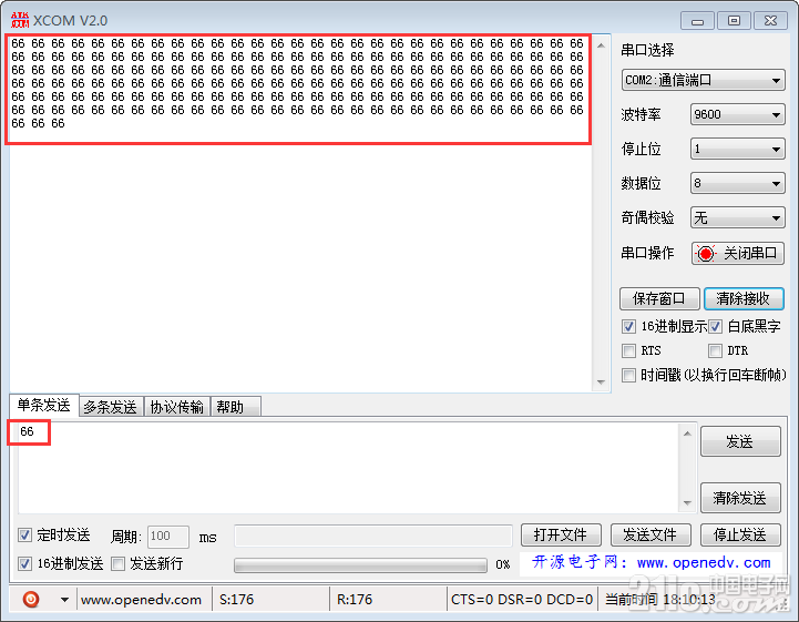

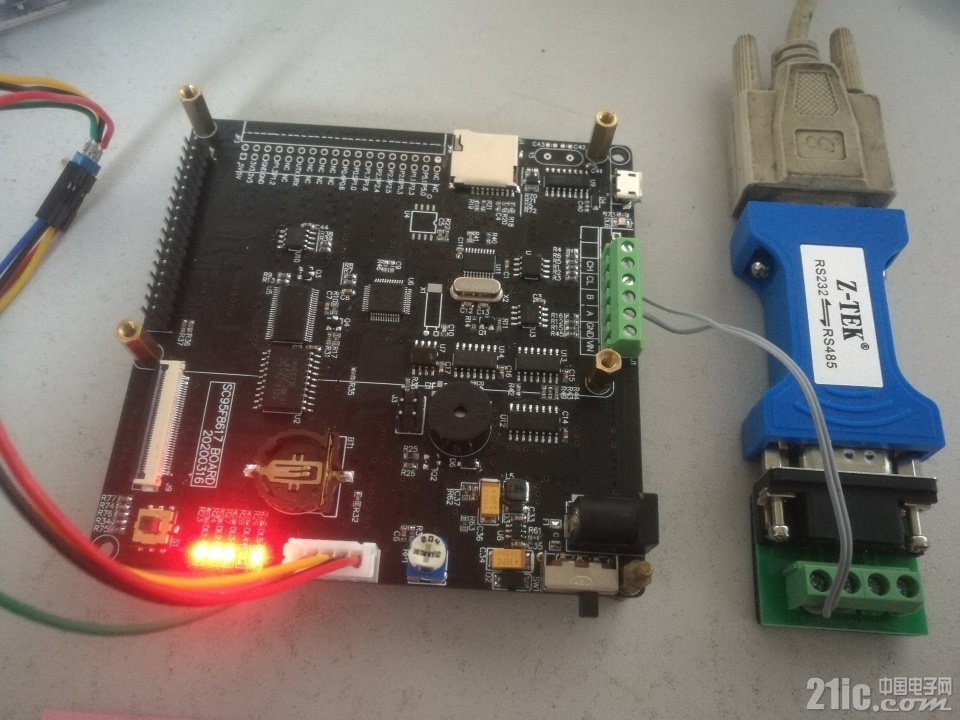

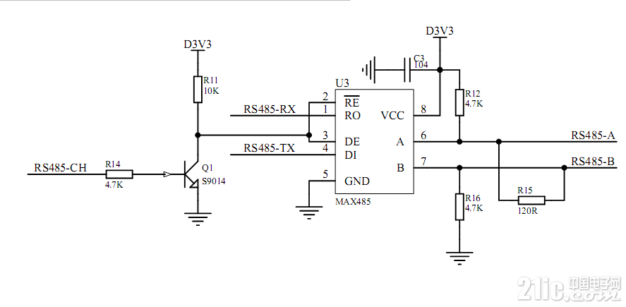

#include "config.h" void main(void) { uint i=0; Init_led(); Init_key(); Init_uart(32, 9600); Init_rs485(); uart_chl(0); //RS485 while(1) { } } 2.2、uart.c 复制#include "config.h" bit UartSendFlag = 0; //·¢ËÍÖжϱê־λ bit UartReceiveFlag = 0; //½ÓÊÕÖжϱê־λ void uart_chl(uchar ul) { switch (ul) { case 0: //rs485 UART_CHA=0; UART_CHB=0; break; case 1: //usb-ttl UART_CHA=1; UART_CHB=0; break; default: break; } } void Init_uart(uint Freq, unsigned long int baud) { P2CON &= ~0x03; P2PH |= 0x03; P5CON &= ~0x14 ; //0001 0100 P5CON |= 0x14 ; P5PH |= 0x14; SCON |= 0X50; TMCON |= 0X02; TH1 = (Freq*1000000/baud)>>8; TL1 = Freq*1000000/baud; TR1 = 0; ET1 = 0; EUART = 1; EA = 1; } void uart_send_char(uchar ch) { SBUF=ch; while(TI==0); TI=0; } void uart_send_string(uchar *str) { while(*str ) { uart_send_char(*str ++); } } ////uartint void UartInt(void) interrupt 4 { // if(TI) // { // TI = 0; // UartSendFlag = 1; // } if(RI) { RI = 0; //UartReceiveFlag = 1; rs485_send_char(SBUF); } } void Init_rs485(void) { P5CON &= ~0x02 ;//0000 0010 P5CON |= 0x02 ; RS485_RX(); } void rs485_send_char(uchar dat) { RS485_TX(); uart_send_char(dat); RS485_RX(); } 2.3、uart.h 复制#ifndef __UART_H__ #define __UART_H__ sbit UART_CHA = P5^2; sbit UART_CHB = P5^4; sbit RS485_CH = P5^1; //1--RX 0--TX #define RS485_RX() RS485_CH=1 #define RS485_TX() RS485_CH=0 void Init_uart(uint Freq, unsigned long int baud); void uart_chl(uchar ul); void uart_send_char(uchar ch); void uart_send_string(uchar *str); void Init_rs485(void); void rs485_send_char(uchar dat); #endif 三、运行 3.1、连接图 3.2、RS485收到一个字节,再发送出去。
