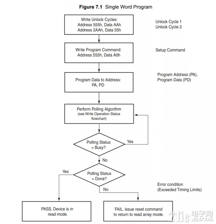

以单个Word编程为例,如下为写单个Word的流程图与实现代码:
  1. NOR_Status FSMC_NOR_WriteHalfWord(u32 WriteAddr, u16 Data)
  3.     NOR_WRITE(ADDR_SHIFT(0x0555), 0x00AA);
  4.     NOR_WRITE(ADDR_SHIFT(0x02AA), 0x0055);
  5.     NOR_WRITE(ADDR_SHIFT(0x0555), 0x00A0);
  6.     NOR_WRITE((NOR_FLASH_START_ADDR + WriteAddr), Data);
  7.     return (FSMC_NOR_GetStatus(Program_Timeout));
  8. }
