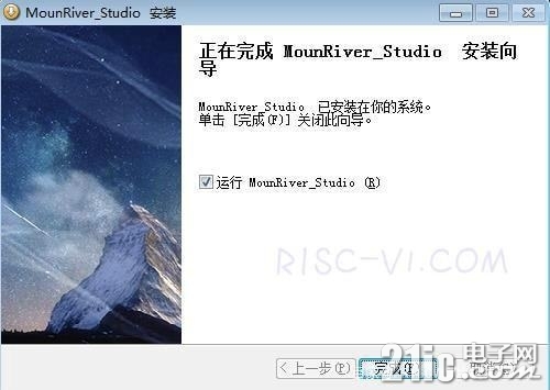

Step2 :解压后,双击第一个 文件, 进行安装 ,如图2
?url=http%3A%2F%2Fdingyue.ws.126.net%2F2021%2F1108%2Fbf48d81dp00r29alc001pd000ga0037p.jpg

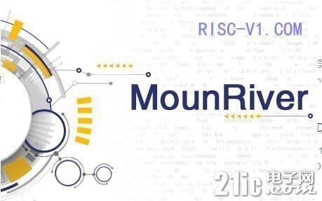

Step3: 点击NEXT ,直到安装完成,如图3
?url=http%3A%2F%2Fdingyue.ws.126.net%2F2021%2F1108%2F9d11552fj00r29alr000wd000dw009vp.jpg

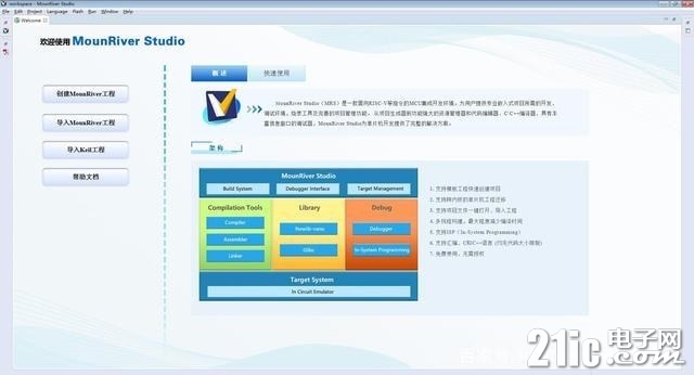

Step4 : 安装完成后,桌面上会出现,MounRiver Studio快捷图标,双击打开如图4
?url=http%3A%2F%2Fdingyue.ws.126.net%2F2021%2F1108%2F32aa943ej00r29am5000pd000cr007zp.jpg

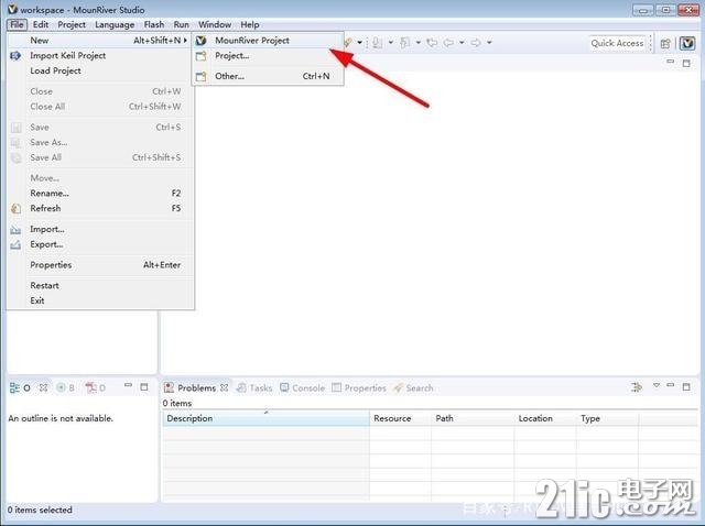

Step6:正式开始体验,新建项目,如图6
?url=http%3A%2F%2Fdingyue.ws.126.net%2F2021%2F1108%2F1a1c23caj00r29amy000yd000hs00dap.jpg

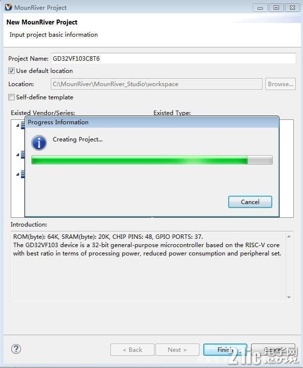

Step7:箭头所指的是WCH,GD的32位 RISC-V 单片机芯片
尤其是GD的,全球首款32位通用RISC-V单片机。我们就选这款芯片GD32VF103。点击,Finish。如图7,图8
?url=http%3A%2F%2Fdingyue.ws.126.net%2F2021%2F1108%2Fa54b163ej00r29anp0023d000hb00ktp.jpg
?url=http%3A%2F%2Fdingyue.ws.126.net%2F2021%2F1108%2F2718a9f3j00r29any001rd000h800kwp.jpg
