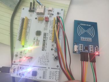

开发板                             rc522
PA4 <----------------------------->SDA(NSS)
PA5 <----------------------------->SCK
PA6 <----------------------------->MISO
PA7 <----------------------------->MOSI
PA3   <-----------------------------> RST
3.3V  <----------------------------->3V3
GND <----------------------------->GND

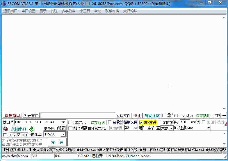

7、实验现象
