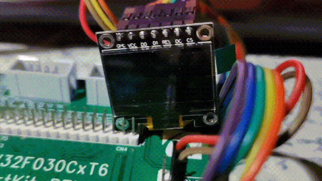

此篇介绍使用硬件SPI1轮询模式来实现驱动OLED显示屏
硬件连接
GND ——  GND
VCC ——  3.3V
DO  ——  PA5
DI  ——  PA7
RES ——  PB1
DC  ——  PB0
CS  ——  PA4
软件代码
SPI1配置:
  1. //SPI初始化
  2. void SPI_Initial(void)
  3. {
  4.     SPI_InitTypeDef SPI_InitStructure;
  5.     GPIO_InitTypeDef GPIO_InitStructure;
  6.     /* Enable GPIO clock for SPI_MASTER */
  7.     RCC_AHBPeriphClk_Enable(SPI_MASTER_GPIO_CLK | RCC_SPI_CS, ENABLE);
  8.     /* Enable SPI_MASTER Periph clock */
  9.     RCC_APBPeriphClk_Enable2(SPI_MASTER_CLK, ENABLE);
  10.     //SPI SCK MOSI MISO 复用
  11.     SPI_AF_SCK;
  12.     SPI_AF_MISO;
  13.     SPI_AF_MOSI;
  14.     //GPIO_CS初始化设置
  15.     GPIO_InitStructure.Pins = PIN_SPI_CS;
  16.     GPIO_InitStructure.Speed = GPIO_SPEED_HIGH;
  17.     GPIO_InitStructure.IT = GPIO_IT_NONE;
  18.     GPIO_InitStructure.Mode = GPIO_MODE_OUTPUT_PP;
  19.     GPIO_Init(PORT_SPI_CS, &GPIO_InitStructure);
  20.     SPI_CS_DISABLE;
  21.     /* Configure SPI_MASTER pins: SCK and MOSI ---------------------------------*/
  22.     /* Configure SCK and MOSI pins as Alternate Function Push Pull */
  23.     GPIO_InitStructure.Pins = SPI_MASTER_PIN_SCK | SPI_MASTER_PIN_MOSI;
  24.     GPIO_InitStructure.Mode = GPIO_MODE_OUTPUT_PP;
  25.     GPIO_InitStructure.Speed = GPIO_SPEED_HIGH;
  26.     GPIO_Init(SPI_MASTER_GPIO, &GPIO_InitStructure);
  27.     /* Configure MISO pin as Input Floating  */
  28.     GPIO_InitStructure.Pins = SPI_MASTER_PIN_MISO;
  29.     GPIO_InitStructure.Mode = GPIO_MODE_INPUT;
  30.     GPIO_Init(SPI_MASTER_GPIO, &GPIO_InitStructure);
  31.     /* SPI_MASTER configuration ------------------------------------------------*/
  32.     SPI_InitStructure.SPI_Direction = SPI_Direction_2Lines_FullDuplex;    // 双线全双工
  33.     SPI_InitStructure.SPI_Mode = SPI_Mode_Master;                         // 主机模式
  34.     SPI_InitStructure.SPI_DataSize = SPI_DataSize_8b;                     // 帧数据长度为8bit
  35.     SPI_InitStructure.SPI_CPOL = SPI_CPOL_High;                           // 时钟空闲电平为高
  36.     SPI_InitStructure.SPI_CPHA = SPI_CPHA_2Edge;                          // 第2个边沿采样
  37.     SPI_InitStructure.SPI_NSS = SPI_NSS_Soft;                             // 片选信号由SSI寄存器控制
  38.     SPI_InitStructure.SPI_BaudRatePrescaler = SPI_BaudRatePrescaler_128;  // 波特率为PCLK的128分频,16M/128=125000
  39.     SPI_InitStructure.SPI_FirstBit = SPI_FirstBit_MSB;                    // 最高有效位 MSB 收发在前
  40.     SPI_InitStructure.SPI_Speed = SPI_Speed_Low;                          // 低速SPI
  41.     SPI_Init(SPI_MASTER, &SPI_InitStructure);
  42.     /* Enable SPI_MASTER */
  43.     SPI_Cmd(SPI_MASTER, ENABLE);
  44. }

运行测试
测试代码
CW32F030CxTx_HW_SPI_OLED.zip (261.26 KB, 下载次数: 12)
打赏榜单
21ic小管家 打赏了 50.00 元 2022-08-10
理由:贡献奖
weifeng90 发表于 2022-8-8 08:43 来自手机 | 显示全部楼层
GIF动图显示不完整
 楼主| zhouminjie 发表于 2022-8-8 16:37 | 显示全部楼层
拍视频时候没有拍完整
