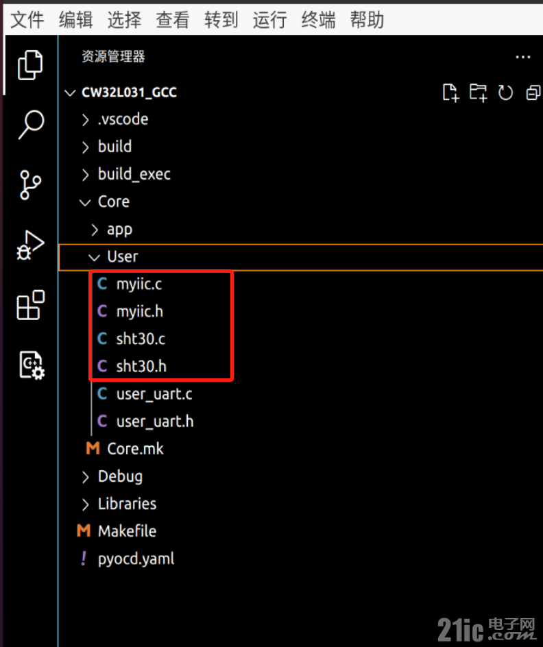

1、复制一份uart的工程到新的文件夹:
lugl@lugl-virtual-machine:~/CW32L$ sudo cp -r cw32l031_uart_iqr cw32l031_sht30
[sudo] lugl 的密码:
lugl@lugl-virtual-machine:~/CW32L$ ls
cw32l031_sht30       cw32l083_gcc      MRS_Toolchain_Linux_x64_V1.50.tar.xz
cw32l031_uart      cw32l083_gcc.zip
cw32l031_uart_iqr  MRS
2、修改文件夹读写权限:
lugl@lugl-virtual-machine:~/CW32L$ chmod 777 -R cw32l031_sht30
3、用vscode打开文件夹。在User目录下面新建sht30.c、sht30.h,myiic.h、myiic.c
dd2a78fc16c9e45172696daa300bedc3
4、这里的我们选用PB10、PB11为IIC的SCL与SDA,创建模拟的IIC。

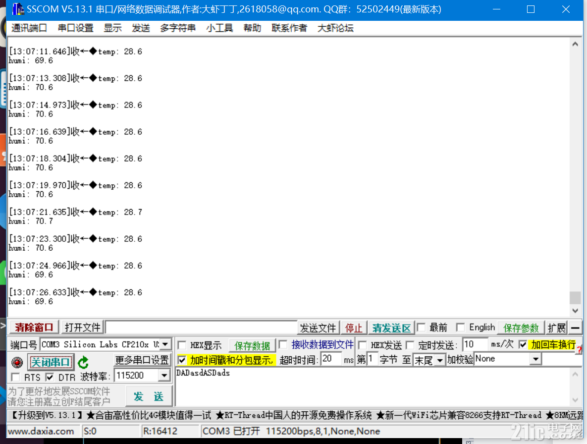

6、调整主程序代码如下:
  1. int main(void)
  3. int t[6];
  4. uint16_t h[6];
  5. LED_Init();
  6. LogInit();
  7. SHT30_Init();
  8. USART_ITConfig(CW_UART1, USART_IT_RC, ENABLE);
  9. InitTick(24000000ul); //初始化SysTick
  10. // 开启两线调试接口
  11. RCC_SWDIO_Config(RCC_SYSCTRL_SWDIOEN);
  12. printf("start\r\n");
  13. while (1)
  14. {
  15. SHT30_Read_Humiture(t,h);
  16. printf("temp: %d.%d\r\n", t[0]/10, t[0]%10);
  17. printf("humi: %d.%d\r\n", h[0]/10, t[0]%10);
  18. GPIO_TogglePin(CW_GPIOC, GPIO_PIN_13);
  19. SysTickDelay(500);
  20. }
  21. return 0;
  22. }
编译并下载:
lugl@lugl-virtual-machine:~/CW32L/cw32l031_sht30/cw32l031_gcc$ make flash
-e Start pyOCD
0000822 I Loading /home/lugl/CW32L/cw32l031_sht30/cw32l031_gcc/build_exec/template.elf [load_cmd]
[==================================================] 100%
0002781 I Erased 0 bytes (0 sectors), programmed 0 bytes (0 pages), skipped 20480 bytes (40 pages) at 10.22 kB/s [loader]
实现的效果:
