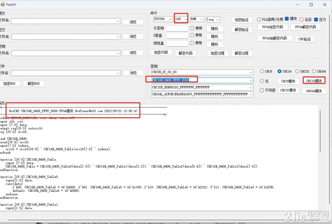

 楼主| hotpower 发表于 2023-9-21 12:02 | 显示全部楼层 |阅读模式
  1. /*-----------------------------------------------------------------------------------------------
  2.       HotCRC CRC16R_8408_FFFF_0000 FPGA模块 HotPower[url=home.php?mod=space&uid=516618]@163.com[/url] 2023-09-21 12:02:01
  3. -----------------------------------------------------------------------------------------------*/
  4. module CRC16R_8408(clk, rst, data, outcrc16)
