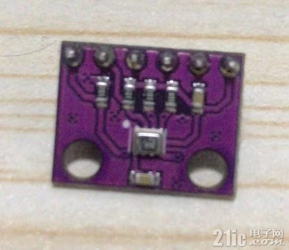

BMP280是博世最推出的数字气压传感器,可以测量气压和温度,支持SPI和I2C通信接口,这里使用I2C来通讯
VCC:3.3V供电:
GND
SCL:时钟信号
SDA:I2C通信模式数据信号,SPI模式模块数据输入
CSB:通信模式选择,高电平I2C,低电平SPI,模块通过电阻上拉默认I2C模式
SDO:I2C通信模式下为传感器地址控制位,接GND的时候器件地址为0x76,接高电平为0x77,模块通过电阻下拉,SPI模式下为模块数据输出
I2C需要时钟线和数据线进行双向通讯,GPIO使用开漏模式

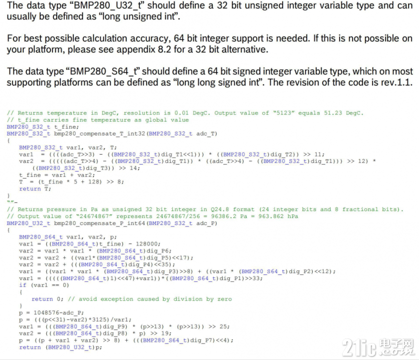

BMP280手册提供的 参考代码

  44. float yuyy_bmp280_readtemp(YUYY_BMP280_DEV_t *bmp280_dev)
  45. {
  46.     int32_t var1, var2;
  47.     float T;
  48.     int32_t adc_T = yuyy_bmp280_read2byte(bmp280_dev,BMP280_REGISTER_TEMPDATA,0);
  49.     adc_T <<= 8;
  50.     adc_T |= yuyy_bmp280_read1byte(bmp280_dev,BMP280_REGISTER_TEMPDATA+2);
  51.     adc_T >>= 4;
  52.     var1  = ((((adc_T>>3) - ((int32_t)bmp280_calib.dig_T1 <<1))) * ((int32_t)bmp280_calib.dig_T2)) >> 11;
  53.     var2  = (((((adc_T>>4) - ((int32_t)bmp280_calib.dig_T1)) * ((adc_T>>4) - ((int32_t)bmp280_calib.dig_T1))) >> 12) * ((int32_t)bmp280_calib.dig_T3)) >> 14;
  54.     t_fine = var1 + var2;
  55.     T  = (t_fine * 5 + 128) >> 8;
  56.     return T/100;
  57. }
  58. float yuyy_bmp280_readpress(YUYY_BMP280_DEV_t *bmp280_dev)
  59. {
  60.     int64_t var1, var2, p;
  61.     int32_t adc_P = yuyy_bmp280_read2byte(bmp280_dev,BMP280_REGISTER_PRESSUREDATA,0);
  62.     adc_P <<= 8;
  63.     adc_P |= yuyy_bmp280_read1byte(bmp280_dev,BMP280_REGISTER_PRESSUREDATA+2);
  64.     adc_P >>= 4;
  65.     var1 = ((int64_t)t_fine) - 128000;
  66.     var2 = var1 * var1 * (int64_t)bmp280_calib.dig_P6;
  67.     var2 = var2 + ((var1*(int64_t)bmp280_calib.dig_P5)<<17);
  68.     var2 = var2 + (((int64_t)bmp280_calib.dig_P4)<<35);
  69.     var1 = ((var1 * var1 * (int64_t)bmp280_calib.dig_P3)>>8) + ((var1 * (int64_t)bmp280_calib.dig_P2)<<12);
  70.     var1 = (((((int64_t)1)<<47)+var1))*((int64_t)bmp280_calib.dig_P1)>>33;
  71.     if (var1 == 0) {
  72.         return 0;  // avoid exception caused by division by zero
  73.     }
  74.     p = 1048576 - adc_P;
  75.     p = (((p<<31) - var2)*3125) / var1;
  76.     var1 = (((int64_t)bmp280_calib.dig_P9) * (p>>13) * (p>>13)) >> 25;
  77.     var2 = (((int64_t)bmp280_calib.dig_P8) * p) >> 19;
  78.     p = ((p + var1 + var2) >> 8) + (((int64_t)bmp280_calib.dig_P7)<<4);
  79.     return (float)p/256;
  80. }
