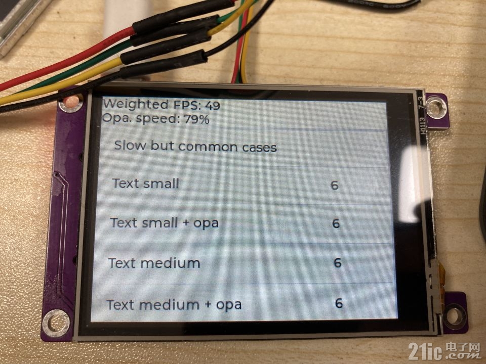

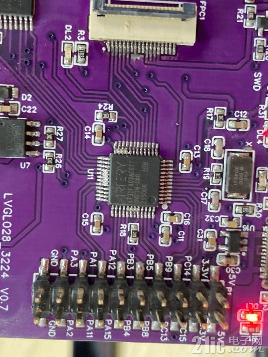

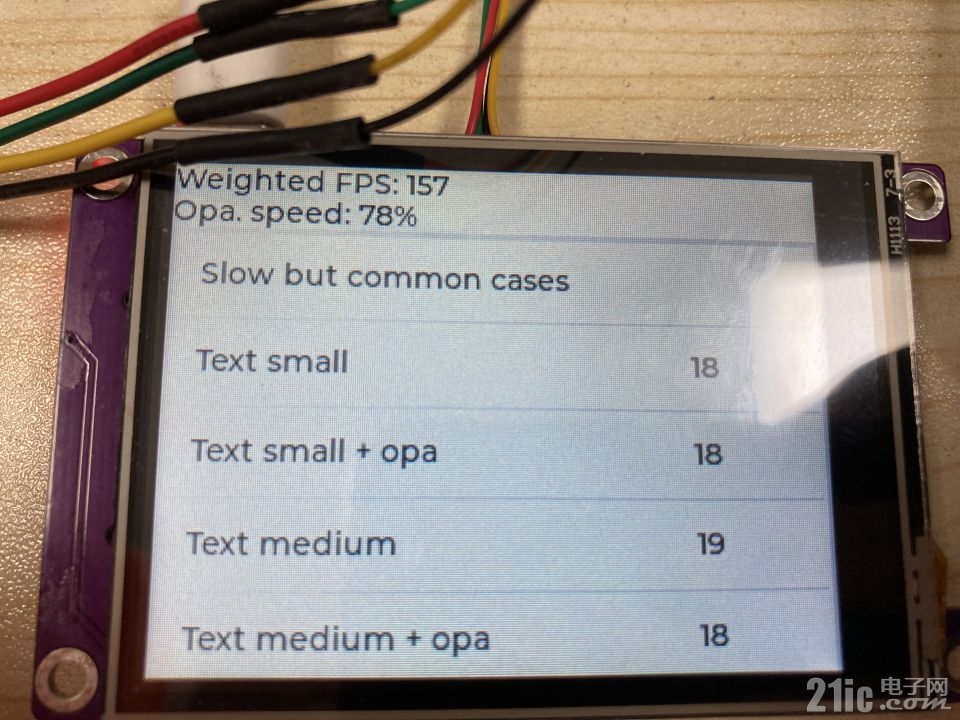

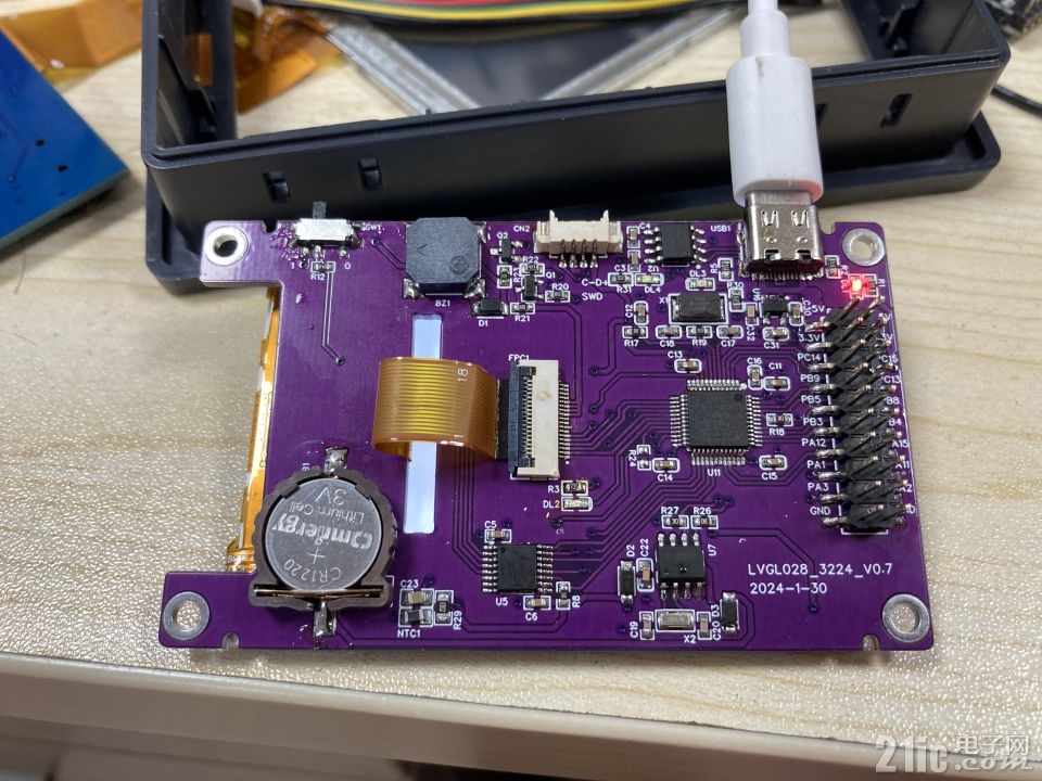

测试MCU型号:AT32F403ACGT6引脚兼容SXX32F103C系列,软件则直接使用SXX32F103的3.5标准库.液晶屏尺寸2.8英寸,分辨率320x240.驱动方式SPI+DMA.
在LVGL8.3.8自带BENCHMARK演示程序中,72M主频运行获得FPS为49,240M主频运行获得FPS为157.
使用3.5标准库打开240M主频的设置:
1. 在system_sxx32f103.c文件中SetSysClockTo72(void)将原来72倍频RCC->CFGR |= (uint32_t)(RCC_CFGR_PLLSRC_HSE | RCC_CFGR_PLLMULL9);替换成
#define  RCC_PLL_MUL30                      ((uint32_t)0x20340000)        /*!< PLL input clock*30 */
RCC->CFGR |= (uint32_t)(RCC_CFGR_PLLSRC_HSE | RCC_PLL_MUL30 | (1<<31));
2. 在sxx32f103rcc.c中RCC_GetClocksFreq(RCC_ClocksTypeDef* RCC_Clocks)原
if ((RCC->CFGR & CFGR_PLLXTPRE_Mask) != (uint32_t)RESET)
        {/* HSE oscillator clock divided by 2 */
          RCC_Clocks->SYSCLK_Frequency = (HSE_VALUE >> 1) * pllmull;
        else
          RCC_Clocks->SYSCLK_Frequency = HSE_VALUE * pllmull;
添加 if( RCC->CFGR & ( 1<<31) )
                        RCC_Clocks->SYSCLK_Frequency = RCC_Clocks->SYSCLK_Frequency <<1;
        else

看到触摸芯片还是2046,几乎看不到有用ns2009的

AT32F403是M4内核吧,能用SXXF103 的库?
M4内核向下兼容M3内核  发表于 2025-2-20 09:14
