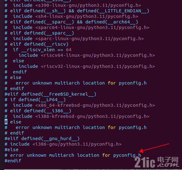

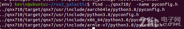

error: #error unknown multiarch location for pyconfig.h
修改文件:/usr/include/python3.11/pyconfig.h:106
替换为:
