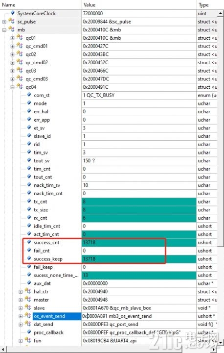

4、MODBUS测试
        本程序开通了4路MODBUS接口,分别使用UART2/3/4/6,其中U3/4做主站,U2/6做从站。
  1.   // master config
  2.         qc03_Init(QC_MODE_MASTER, 115200, MB_PAR_NONE);
  3.         mb.qc03.os_event_send = mb3_os_event_send;
  4.         qc04_Init(QC_MODE_MASTER, 19200, MB_PAR_NONE);
  5.         mb.qc04.os_event_send = mb3_os_event_send;
  6.
  7.         mcmd.id = 1;
  8.         mcmd.wdat = &mb_input[0].uval;
  9.         mcmd.rdat = &mb_input[0].uval;
  10.         mcmd.wa = 0;
  11.         mcmd.wn = 96;
  12.         mcmd.ra = 0x1800;
  13.         mcmd.rn = 1;
  14.         mcmd.callback = qc_callback;
  15.         mcmd.attr = QC_MB_ATTR_HOLD_MW;
  16.         mqc_stc_cmd_req(&mb.qc03, 0, &mcmd);
  17.         mqc_stc_cmd_req(&mb.qc04, 0, &mcmd);
  18.
  19.         mcmd.wdat = &mb_input[0].uval;
  20.         mcmd.wa = 96;
  21.         mcmd.wn = 96;
  22.         mqc_stc_cmd_req(&mb.qc03, 1, &mcmd);
  23.         mqc_stc_cmd_req(&mb.qc04, 0, &mcmd);
  24.
  25.         // slave config
  26.         qc02_Init(QC_MODE_SLAVE, 115200, MB_PAR_NONE);
  27.         mb.qc02.os_event_send = mb2_os_event_send;
  28.
  29.         qc06_Init(QC_MODE_SLAVE, 19200, MB_PAR_NONE);
  30.         mb.qc06.os_event_send = mb8_os_event_send;
  31.
  32.         mcmd.id = 1;
  33.         mcmd.wdat = &mb_input[0].uval;
  34.         mcmd.rdat = &mb_input[0].uval;
  35.         mcmd.wa = 16;
  36.         mcmd.wn = 16;
  37.         mcmd.ra = 0;
  38.         mcmd.rn = 8;
  39.         mcmd.callback = qc_callback;
  40.         mcmd.attr = QC_MB_ATTR_HOLD_MW;
  41.
  42.         mqc_stc_cmd_req(&mb.qc02, 0, &mcmd);
  43.         mqc_stc_cmd_req(&mb.qc02, 1, &mcmd);
  44.         mqc_stc_cmd_req(&mb.qc06, 0, &mcmd);
  45.         mqc_stc_cmd_req(&mb.qc06, 1, &mcmd);
连接U4和U6可以进行通信,调试状态测试结果如下
