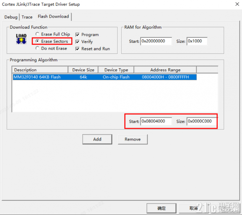

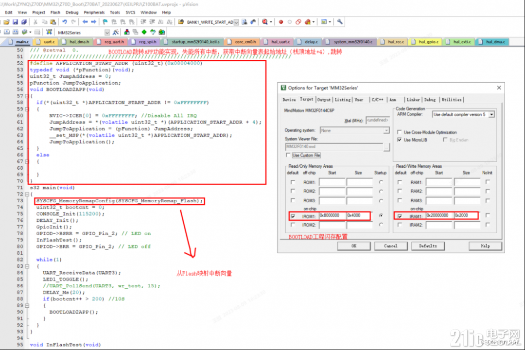

三、Bootload工程配置
3.1 闪存配置
3.2 烧录配置
3.3 跳转实现代码
#define APPLICATION_START_ADDR (uint32_t)(0x08004000)
typedef void (pFunction)(void);
uint32_t JumpAddress = 0;
pFunction JumpToApplication;
void BOOTLOAD2APP(void)
if((uint32_t *)APPLICATION_START_ADDR != 0xFFFFFFFF)
NVIC->ICER[0] = 0xFFFFFFFF; //Disable All IRQ
JumpAddress = *(volatile uint32_t )(APPLICATION_START_ADDR + 4);
JumpToApplication = (pFunction) JumpAddress;
__set_MSP((volatile uint32_t *)APPLICATION_START_ADDR);
JumpToApplication();

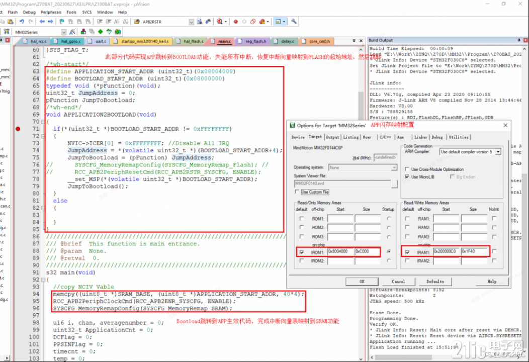

四、 Application工程配置
4.1 内存映射配置
4.2 烧录配置
4.3 跳转实现代码
#define BOOTLOAD_START_ADDR (uint32_t)(0x08000000)
pFunction JumpToBootload;
void APPLICATION2BOOTLOAD(void)
if((uint32_t *)BOOTLOAD_START_ADDR != 0xFFFFFFFF)
JumpAddress = *(volatile uint32_t )(BOOTLOAD_START_ADDR+4);
JumpToBootload = (pFunction) JumpAddress;
// SYSCFG_MemoryRemapConfig(SYSCFG_MemoryRemap_Flash);
// RCC_APB2PeriphResetCmd(RCC_APB2RSTR_SYSCFG, ENABLE);
__set_MSP((volatile uint32_t *)BOOTLOAD_START_ADDR);
JumpToBootload();
else
