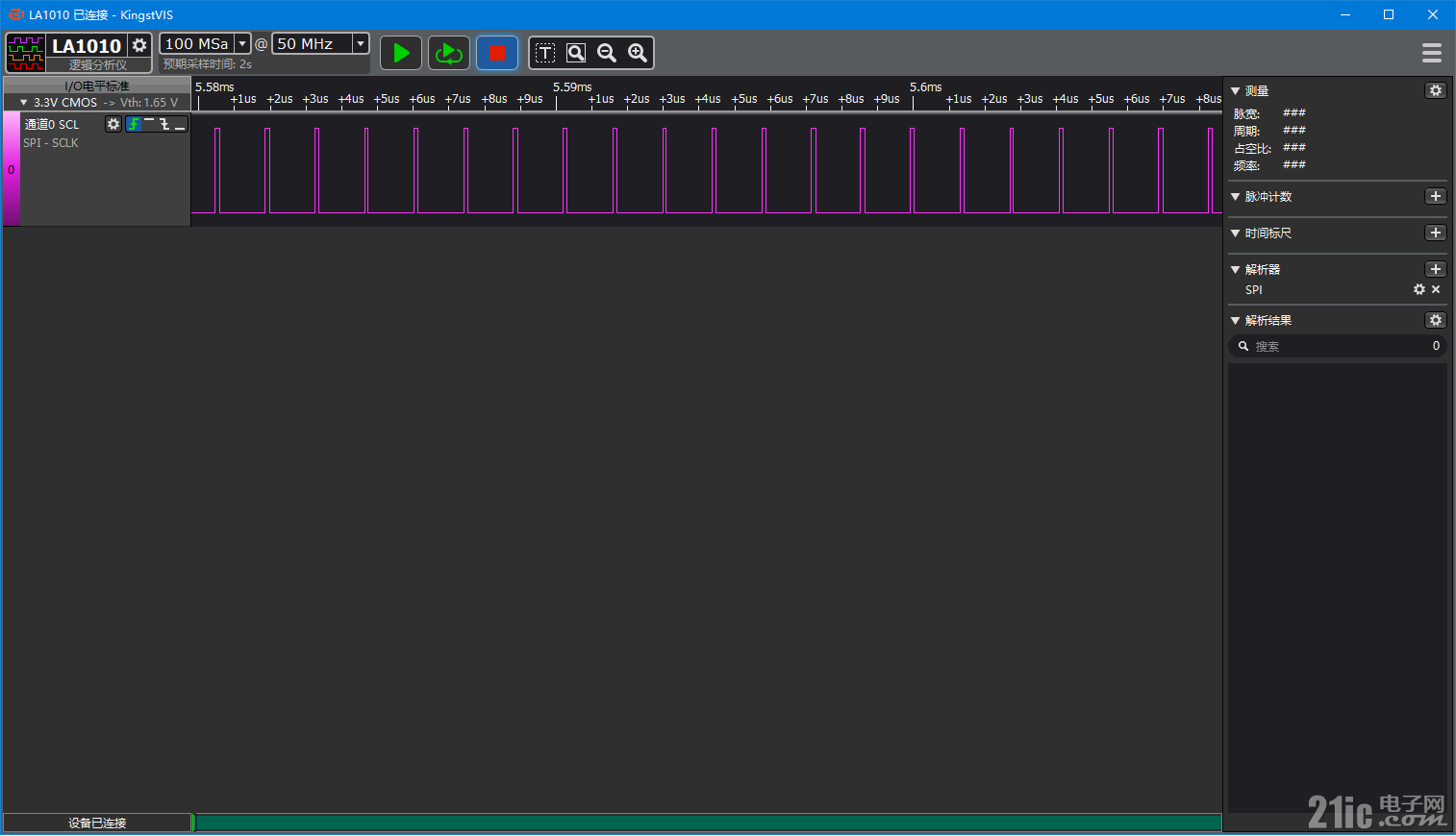

PWM的应用很广。MB-025自身提供的例程中,使用定时器3在PB4上输出PWM波。
主程序很简单:
s32 main(void) {
    u8 dir = 1;
    u16 led0pwmval = 0;
    DELAY_Init();
    CONSOLE_Init(115200);
    LED_Init();
    // 使用定时器3处理PWM输出
    TIM3_PWM_Init(99, 0); //register  fractional frequency
    while(1) {
        DELAY_Ms(4);
        if(dir)led0pwmval++;
        else led0pwmval--;
        if(led0pwmval > 300)dir = 0;
        if(led0pwmval == 0)dir = 1;
        TIM3->CCR1 = led0pwmval;
定时器的初始化处理:
void TIM3_PWM_Init(u16 arr, u16 psc) {
    RCC->APB1ENR |= RCC_APB1ENR_TIM3EN; //TIM3clock enable
    RCC->AHBENR |= RCC_AHBENR_GPIOB; //RCC->APB2ENR|=1<<3;  //enablePORTBclock
    //SYSCFG->CFGR|=0x1<<11;
    GPIOB->AFRL &= (~(GPIO_AFRL_AFR4));
    GPIOB->AFRL |= GPIO_AF_MODE1 << (16);
    GPIOB->CRL &= (GPIO_CNF_MODE_AF_PP << GPIO_CRL_CNF_MODE_4_Pos); //PB4clear set
    GPIOB->CRL |= GPIO_CRL_MODE4 | GPIO_CRL_CNF4_1; // function output
    TIM3->ARR = arr;
    TIM3->PSC = psc;
    TIM3->CCMR1 |= TIM_CCMR1_IC1F_0 | TIM_CCMR1_IC1F_1 | TIM_CCMR1_IC1F_2; //CH1 PWM2 mode
    TIM3->CCMR1 |= TIM_CCMR1_OC1PE;     //CH1 preloaded enable
    TIM3->CCER |= TIM_CCER_CC1E;    //OC1  output enable
    TIM3->CR1 = TIM_CR1_ARPE;   //ARPEenable
    TIM3->CR1 |= TIM_CR1_CEN;   //enabletiming  device1
在CN9,标号为56的排针脚上可以测量到PWM波(使用逻辑分析仪):
占空比是递增递减模式变化的,使蓝色LED呈现为渐亮渐灭的变化。
