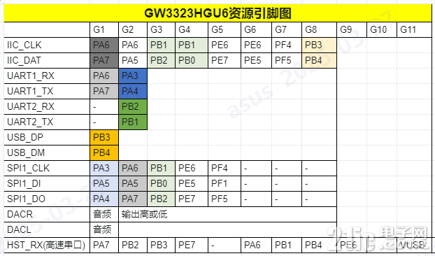

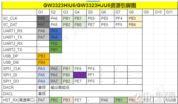

极海GW3323系列芯片,有BT,SPI,UART,USB等资源,封装为QFN40.为方便硬件开发工程师快速输出原理图,故整理里外设资源对应的引脚表。注意:1MB和4MB芯片的引脚定义不同,PCB板不一样,请以极海官网GW3323对应开发板原理图做参考。
GW3323HGU6资源引脚图 |
| G1 | G2 | G3 | G4 | G5 | G6 | G7 | G8 | G9 | G10 | G11 | IIC_CLK | PA6 | PA6 | PB1 | PB1 | PE6 | PE6 | PF4 | PB3 |
| | IIC_DAT | PA7 | PA5 | PB2 | PB0 | PE7 | PE5 | PF5 | PB4 |
| | UART1_RX | PA6 | PA3 | | | | | | |
| | UART1_TX | PA7 | PA4 | | | | | | |
| | UART2_RX | - | PB2 | | | | | | |
| | UART2_TX | - | PB1 | | | | | | |
| | USB_DP | PB3 | | | | | | | |
| | USB_DM | PB4 | | | | | | | |
| | SPI1_CLK | PA3 | PA6 | PB1 | PE6 | PF4 | - | - | - |
| | SPI1_DI | PA5 | PA5 | PB0 | PE5 | PF1 | - | - | - |
| | SPI1_DO | PA4 | PA7 | PB2 | PE7 | PF5 | - | - | - |
| | DACR | 音频 | 输出高或低 |
| | DACL | 音频 |
| | HST_RX(高速串口) | PA7 | PB2 | PB3 | PE7 | - | PA6 | PB1 | PB4 | PE6 | - | VUSB |
| IIS | G1 | G2 | G3 | | | DI | PA3 | PB2 | PB5 | | | DO | PA7 | PE7 | PE7 | | | BCLK | PA5 | PE5 | PB2 | | | LRCLK | PA6 | PE6 | PE6 | | | MCLK | PA4 | PB1 | PB1 | | | | | | | |
