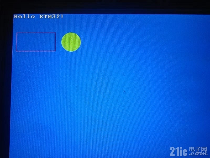

四、一个简单的例子
上面通过2个函数完成了LCD配置,下面开始画图
  1.     UTIL_LCD_SetFont(&Font16);
  2.     UTIL_LCD_SetTextColor(UTIL_LCD_COLOR_WHITE);
  3.     UTIL_LCD_SetBackColor(UTIL_LCD_COLOR_BLUE);
  4.     UTIL_LCD_Clear(UTIL_LCD_COLOR_BLUE);
  5.
  6.     UTIL_LCD_DisplayStringAtLine(0, (uint8_t *)"Hello STM32!");
  7.
  8.     UTIL_LCD_DrawRect(10, 50, 100, 50, UTIL_LCD_COLOR_RED);
  9.     UTIL_LCD_FillCircle(150, 75, 25, UTIL_LCD_COLOR_GREEN);
设置字体、前景色、背景色、清屏、显示字符串,画矩形,画圆

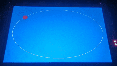

五、一个动图的例子
  1. void Run_Circle_Animation(void)
  3.     int32_t x, y;
  4.     float angle = 0.0f;
  5.     float angle_step = 2 * 3.14159f / ANIMATION_STEPS;
  6.
  7.     // 轨道参数(椭圆)
  8.     uint16_t orbit_x_radius = LCD_WIDTH/2 - CIRCLE_RADIUS - 10;
  9.     uint16_t orbit_y_radius = LCD_HEIGHT/2 - CIRCLE_RADIUS - 10;
  10.
  11.     while(1)
  12.     {
  13.         // 计算圆形位置
  14.         x = LCD_WIDTH/2 + (int32_t)(orbit_x_radius * cosf(angle));
  15.         y = LCD_HEIGHT/2 + (int32_t)(orbit_y_radius * sinf(angle));
  16.
  17.         // 清除上一帧
  18.         UTIL_LCD_SetTextColor(UTIL_LCD_COLOR_BLACK);
  19.         UTIL_LCD_FillCircle(x, y, CIRCLE_RADIUS,UTIL_LCD_COLOR_BLUE);
  20.
  21.         // 更新角度
  22.         angle += angle_step;
  23.         if(angle >= 2*3.14159f) angle = 0;
  24.
  25.         // 计算新位置
  26.         x = LCD_WIDTH/2 + (int32_t)(orbit_x_radius * cosf(angle));
  27.         y = LCD_HEIGHT/2 + (int32_t)(orbit_y_radius * sinf(angle));
  28.
  29.         // 绘制新圆形
  30.         UTIL_LCD_SetTextColor(UTIL_LCD_COLOR_RED);
  31.         UTIL_LCD_FillCircle(x, y, CIRCLE_RADIUS,UTIL_LCD_COLOR_RED);
  32.
  33.         // 绘制轨道(椭圆)
  34.         UTIL_LCD_SetTextColor(UTIL_LCD_COLOR_BLUE);
  35.         UTIL_LCD_DrawEllipse(LCD_WIDTH/2, LCD_HEIGHT/2, orbit_x_radius, orbit_y_radius,UTIL_LCD_COLOR_WHITE);
  36.
  37.         HAL_Delay(DELAY_MS);
  38.     }
  39. }
