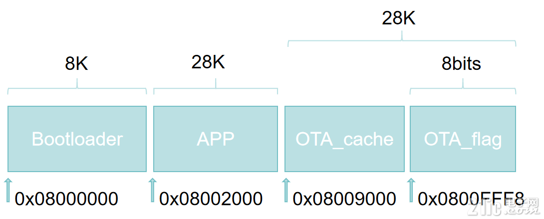

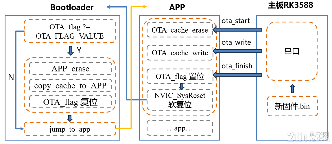

1.Flash分区
2.实现逻辑
3.固件传输协议

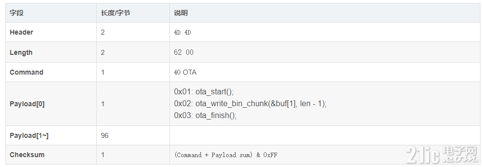

固件由主板通过串口发送给MCU,通讯协议如下:
共103字节
4. Bootloader
main.c

int main(void) {
        rcu_periph_clock_enable(RCU_GPIOA);
    gpio_mode_set(GPIOA, GPIO_MODE_OUTPUT, GPIO_PUPD_NONE, GPIO_PIN_0);
    gpio_output_options_set(GPIOA, GPIO_OTYPE_PP, GPIO_OSPEED_50MHZ, GPIO_PIN_0);
    gpio_bit_set(GPIOA, GPIO_PIN_0);
        if (*(uint32_t *)OTA_FLAG_ADDR == OTA_FLAG_VALUE) {
                copy_ota_to_app();
        SCB->VTOR = APP_ADDR;
    jump_to_app(); // 跳转APP
    while (1); // 不应运行到此

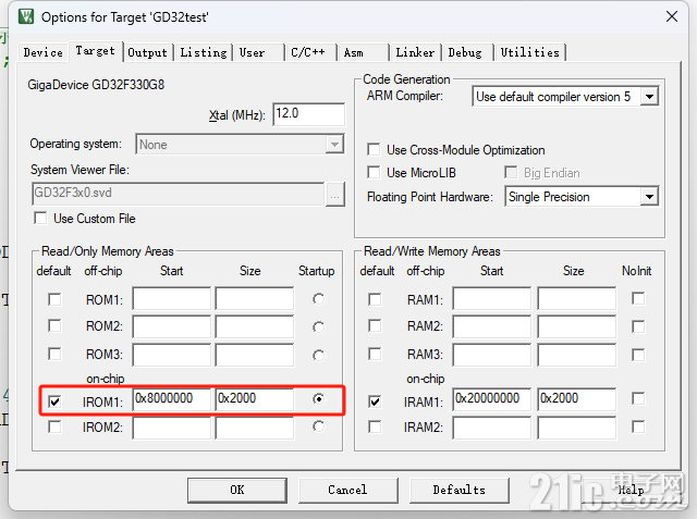

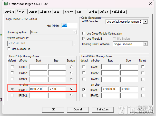

烧录位置配置:

//bootloader 8k  app 28k  ota_cache 28k-8bit  ota_flag 8bit
#define APP_ADDR         0x08002000
#define OTA_CACHE_ADDR   0x08009000
#define OTA_FLAG_ADDR    0x0800FFF8
#define OTA_FLAG_VALUE   0xA5A5A5A5    //有固件写入

void ota_start(void) {
    ota_offset = 0;
        usart_interrupt_disable(USART0, USART_INT_RBNE); // 关闭串口中断 中断干扰flash擦写
    fmc_unlock();
    flash_erase_pages(OTA_CACHE_ADDR, 27 * 1024); //ota_cache 27k 避免擦除ota_flag
    fmc_lock();
    usart_interrupt_enable(USART0, USART_INT_RBNE); // 重新开启串口中断
void ota_write_bin_chunk(uint8_t *data, uint32_t len) {
    fmc_unlock();
    //4字节写入
        for (uint32_t i = 0; i < len; i += 4) {
                uint32_t word = *(uint32_t *)(data + i);
                flash_write_word(OTA_CACHE_ADDR + ota_offset + i, word);
                while (fmc_flag_get(FMC_FLAG_END) == RESET);
    fmc_lock();
    ota_offset += len;
void ota_finish(void) {
    fmc_unlock();
    flash_erase_pages(OTA_FLAG_ADDR, 1024);
        flash_write_word(OTA_FLAG_ADDR, OTA_FLAG_VALUE);
    fmc_lock();
        delay_1ms(1000);
    NVIC_SystemReset();                                           //软复位MCU reset后bootloader检查ota_flag

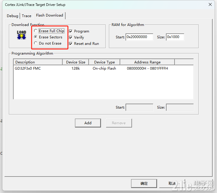

烧录位置及擦除配置:
选择Erase Sectors,避免第一次烧录APP时将Bootloader擦除。

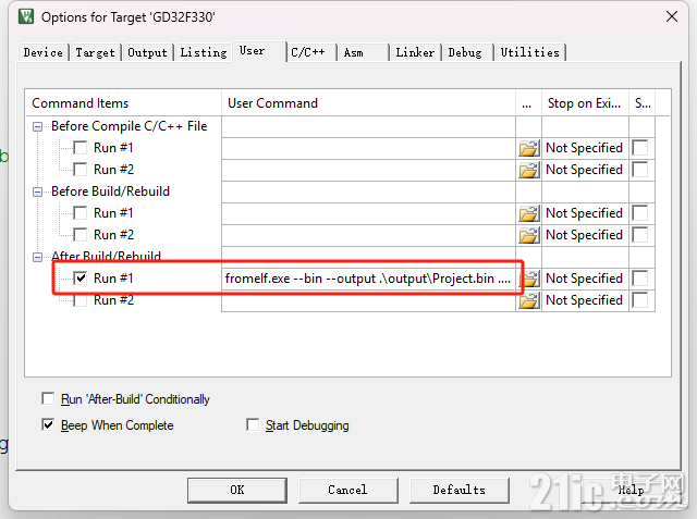

由于新固件以.bin格式传输与接收,默认情况下,编译生成的项目文件为.hex格式,需要添加用户指令:
fromelf.exe --bin --output .\output\Project.bin .\output\Project.axf
如此编译后,output文件夹下会生成bin文件,用于后续的固件发送与更新:

void build_packet(uint8_t *packet, uint8_t ota_cmd, const uint8_t *payload, size_t payload_len) {
    memset(packet, 0, PACKET_SIZE);
    packet[0] = HEADER_BYTE;
    packet[1] = HEADER_BYTE;
    packet[2] = 0x62;  // Length = 0x62 (98 bytes: Command + Payload[96] + Checksum)
    packet[3] = 0x00;
    packet[4] = CMD_OTA;
    packet[5] = ota_cmd;
    if (payload && payload_len > 0) {
        memcpy(&packet[6], payload, payload_len);
    uint8_t sum = CMD_OTA + ota_cmd;
    for (int i = 0; i < 96; ++i)
        sum += packet[6 + i];
    packet[102] = sum & 0xFF;
