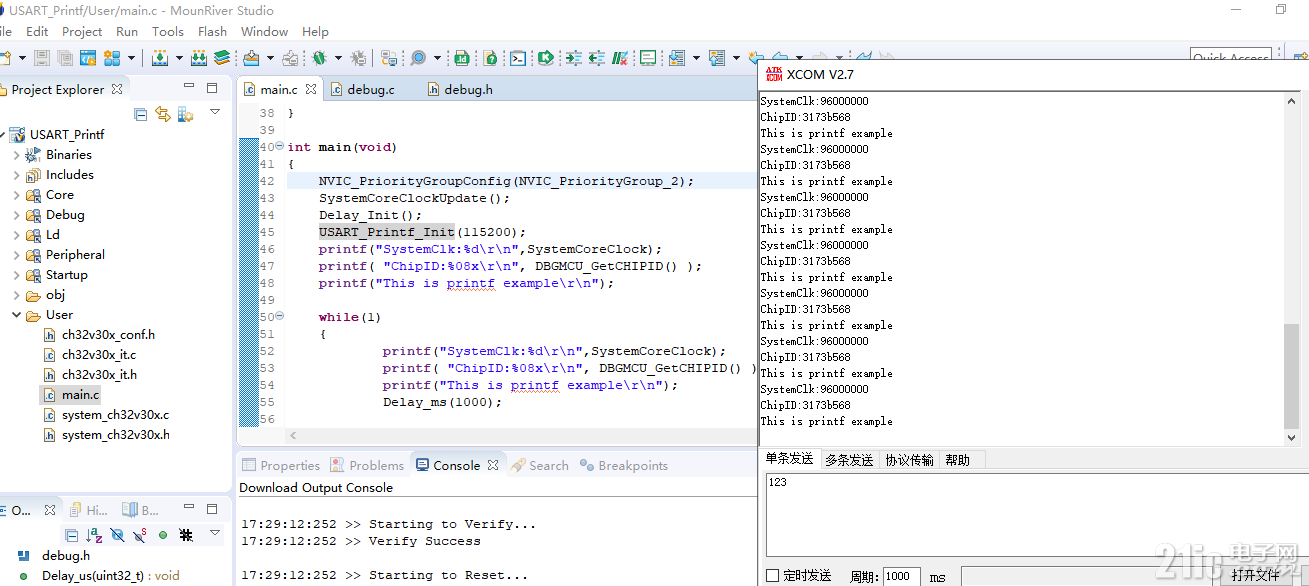

先编写一个串口打印测试:

测试结果:nice!!
  1. SystemClk:96000000
  2. ChipID:3173b568
  3. This is printf example
  4. SystemClk:96000000
  5. ChipID:3173b568
  6. This is printf example
  7. SystemClk:96000000
  8. ChipID:3173b568
  9. This is printf example
  10. SystemClk:96000000
  11. ChipID:3173b568
  12. This is printf example
  13. SystemClk:96000000
  14. ChipID:3173b568
  15. This is printf example
  16. SystemClk:96000000
  17. ChipID:3173b568
  18. This is printf example
  19. SystemClk:96000000
  20. ChipID:3173b568
  21. This is printf example
