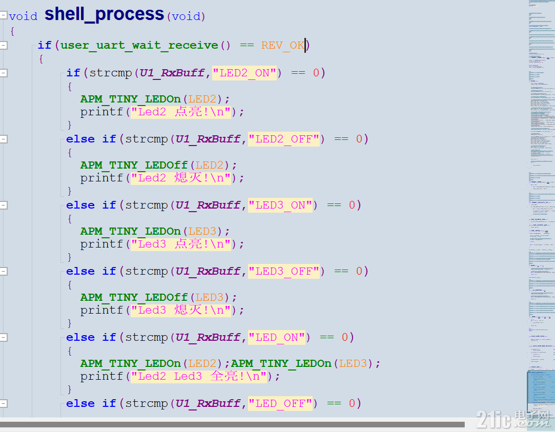

2.核心代码如下
void shell_process(void)
    if(user_uart_wait_receive() == REV_OK)
                if(strcmp(U1_RxBuff,"LED2_ON") == 0)
                  APM_TINY_LEDOn(LED2);
                  printf("Led2 点亮!\n");
                else if(strcmp(U1_RxBuff,"LED2_OFF") == 0)
                  APM_TINY_LEDOff(LED2);
                  printf("Led2 熄灭!\n");
                else if(strcmp(U1_RxBuff,"LED3_ON") == 0)
                  APM_TINY_LEDOn(LED3);
                  printf("Led3 点亮!\n");
                else if(strcmp(U1_RxBuff,"LED3_OFF") == 0)
                  APM_TINY_LEDOff(LED3);
                  printf("Led3 熄灭!\n");
                else if(strcmp(U1_RxBuff,"LED_ON") == 0)
                  APM_TINY_LEDOn(LED2);APM_TINY_LEDOn(LED3);
                  printf("Led2 Led3 全亮!\n");
                else if(strcmp(U1_RxBuff,"LED_OFF") == 0)
                  APM_TINY_LEDOff(LED2);APM_TINY_LEDOff(LED3);
                  printf("Led2 Led3 全灭!\n");
                user_uart_clear();
        HAL_Delay(10);

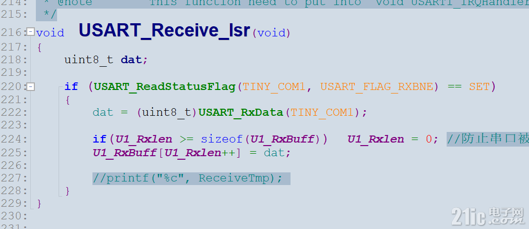

3.串口接收中断函数
void  USART_Receive_Isr(void)
    uint8_t dat;
    if (USART_ReadStatusFlag(TINY_COM1, USART_FLAG_RXBNE) == SET)
        dat = (uint8_t)USART_RxData(TINY_COM1);
                if(U1_Rxlen >= sizeof(U1_RxBuff))        U1_Rxlen = 0; //防止串口被刷爆
                U1_RxBuff[U1_Rxlen++] = dat;
        //printf("%c", ReceiveTmp);

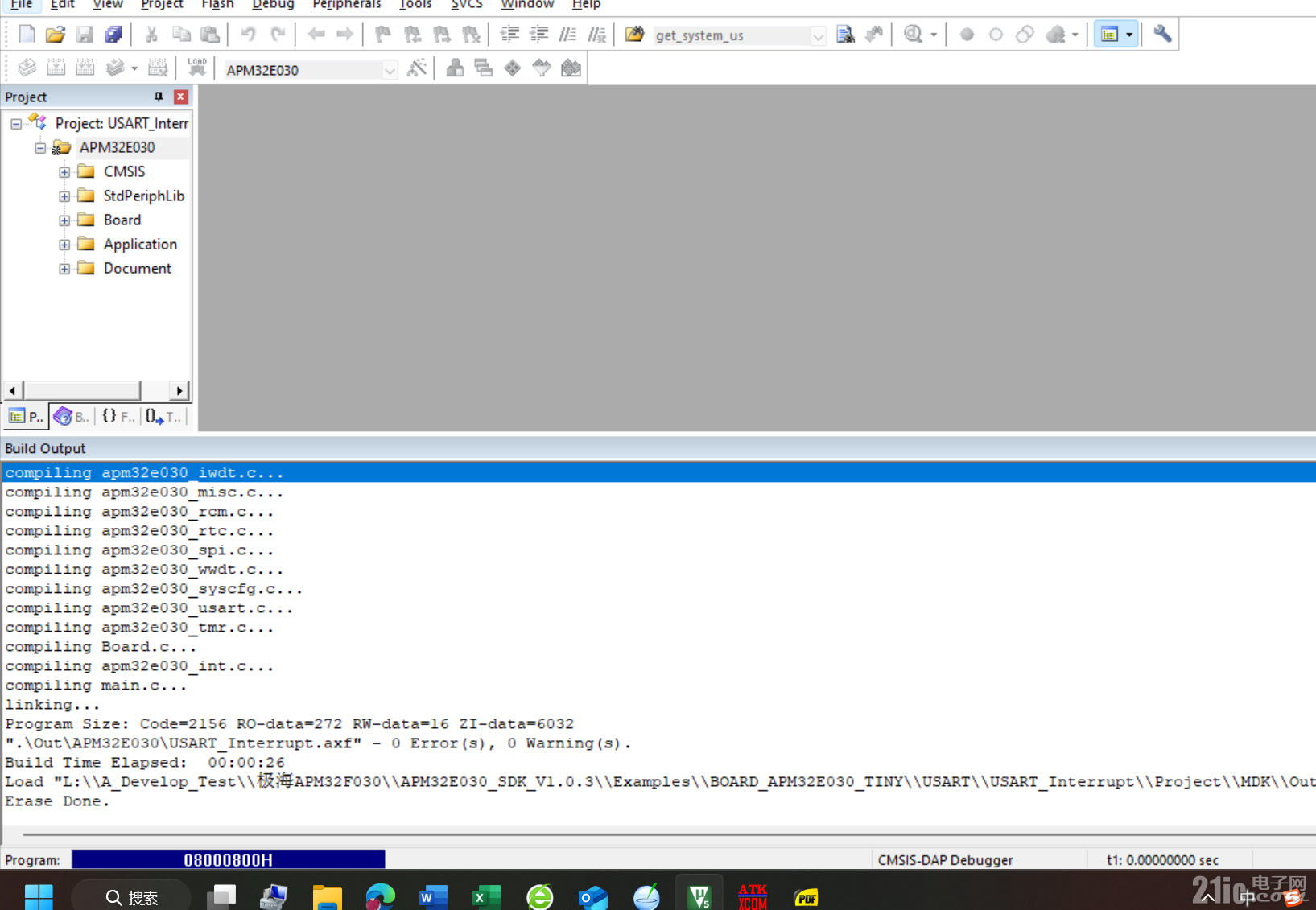

5.编译烧录代码到板子

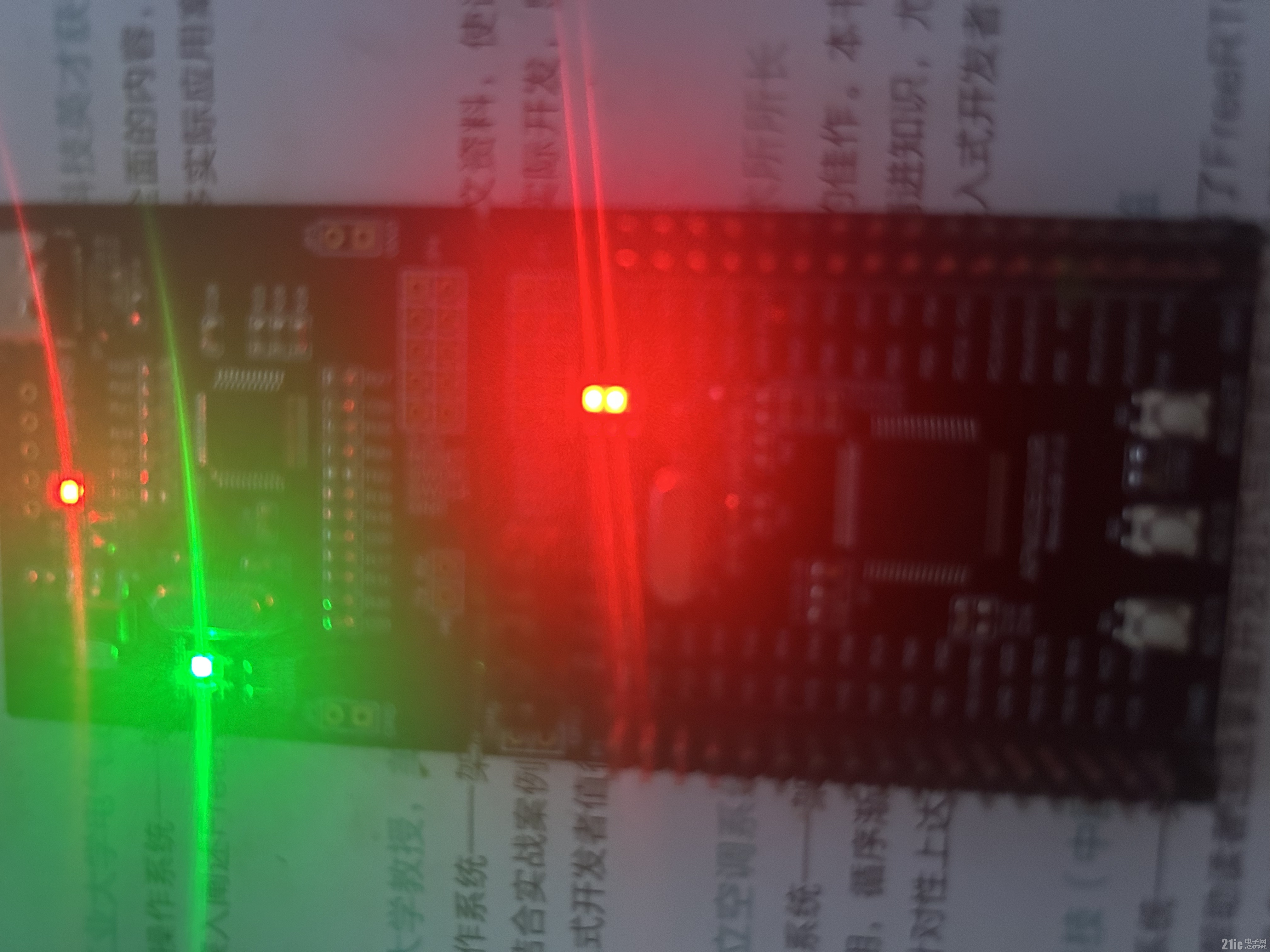

1.板子上LED2和LED3是熄灭的
上面亮的是LED1

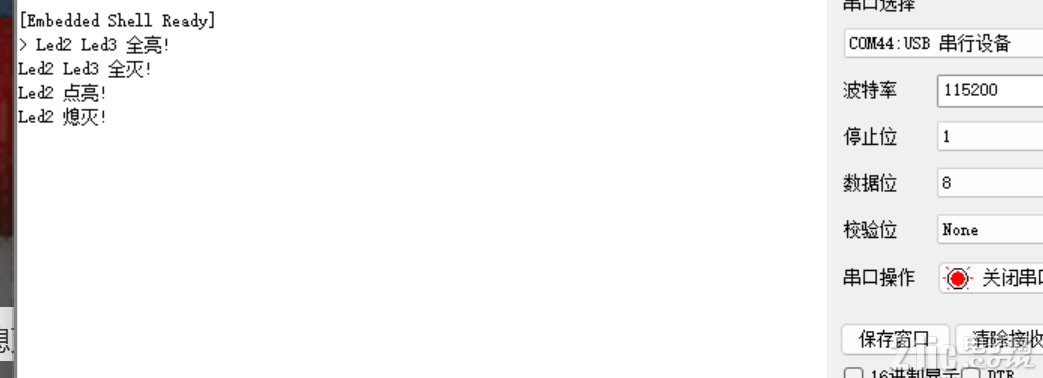

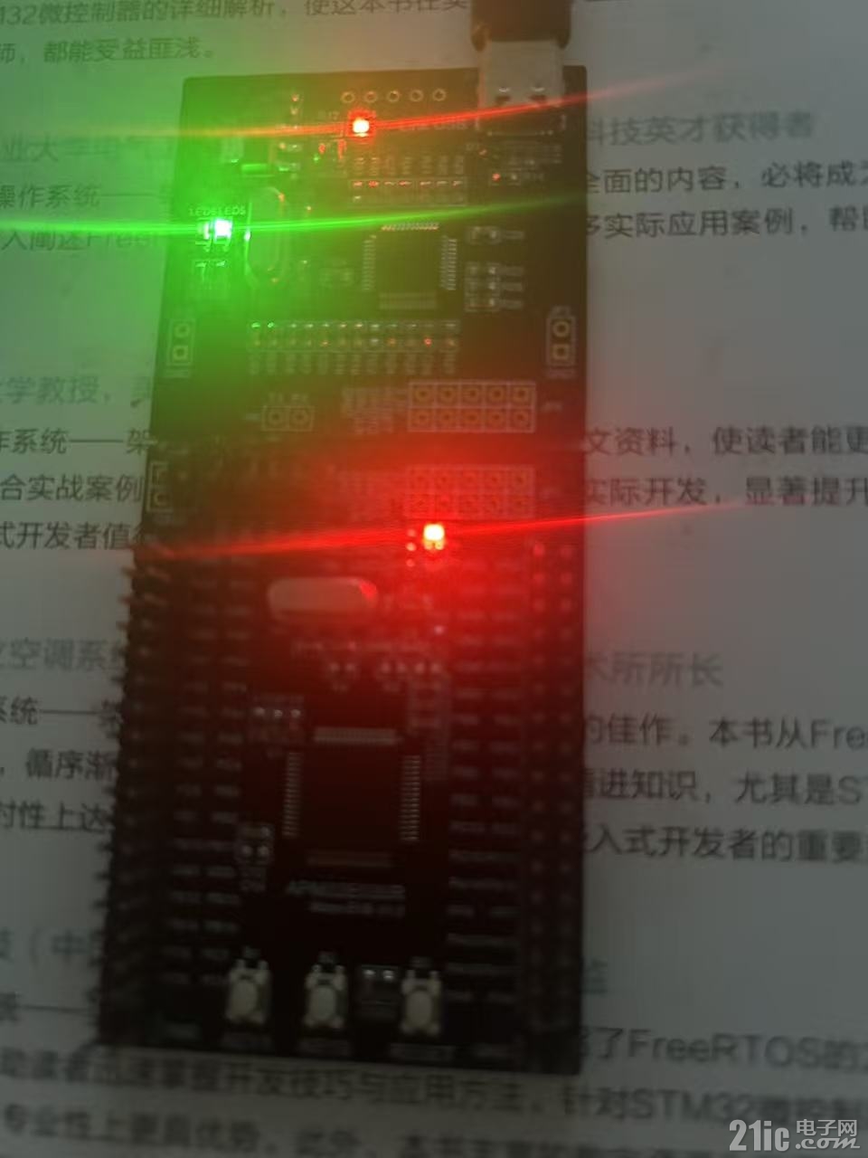

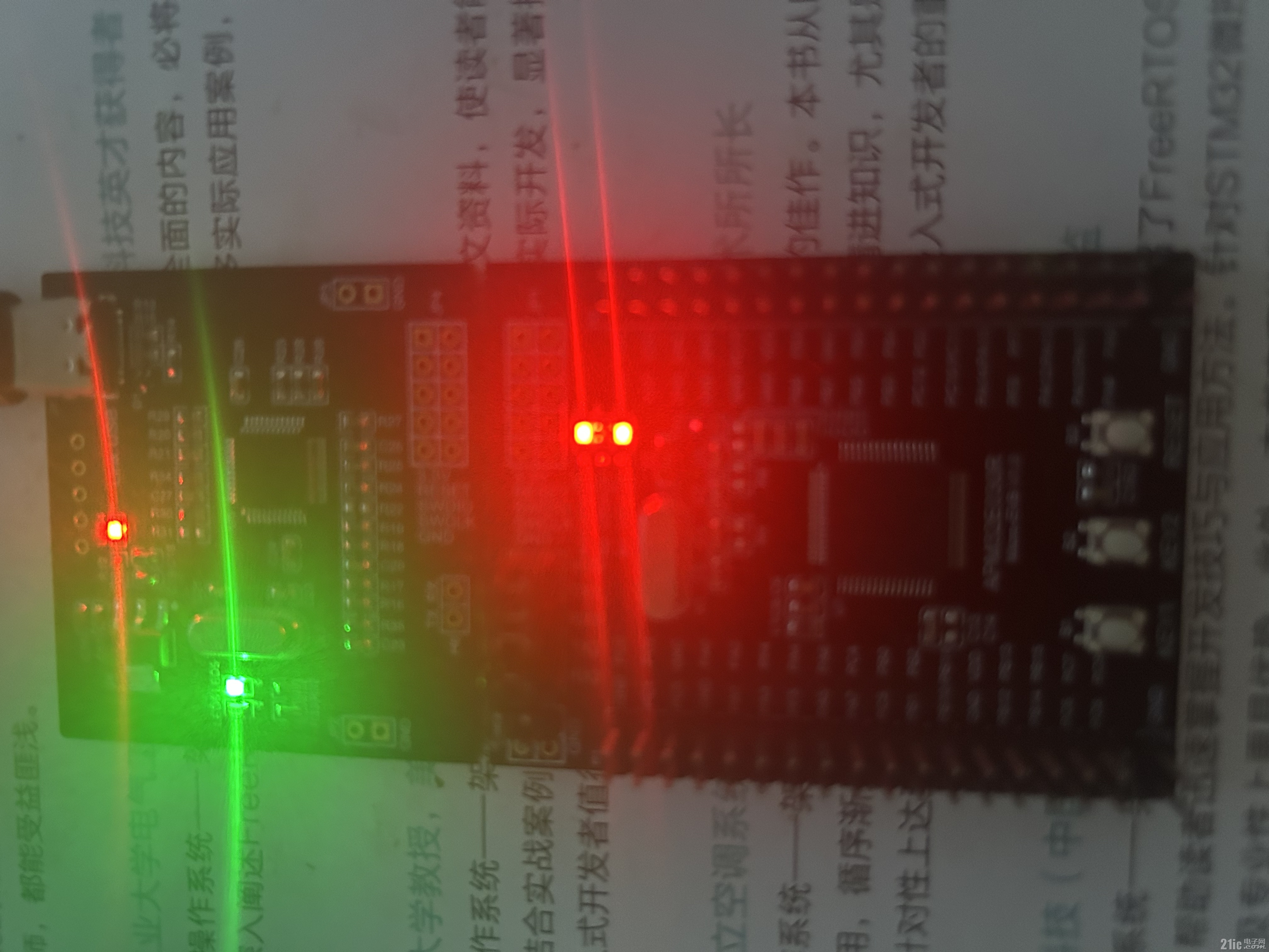

2.发送LED_ON,LED2和LED3全亮
3.发送LED_OFF , LED2 LED3全灭

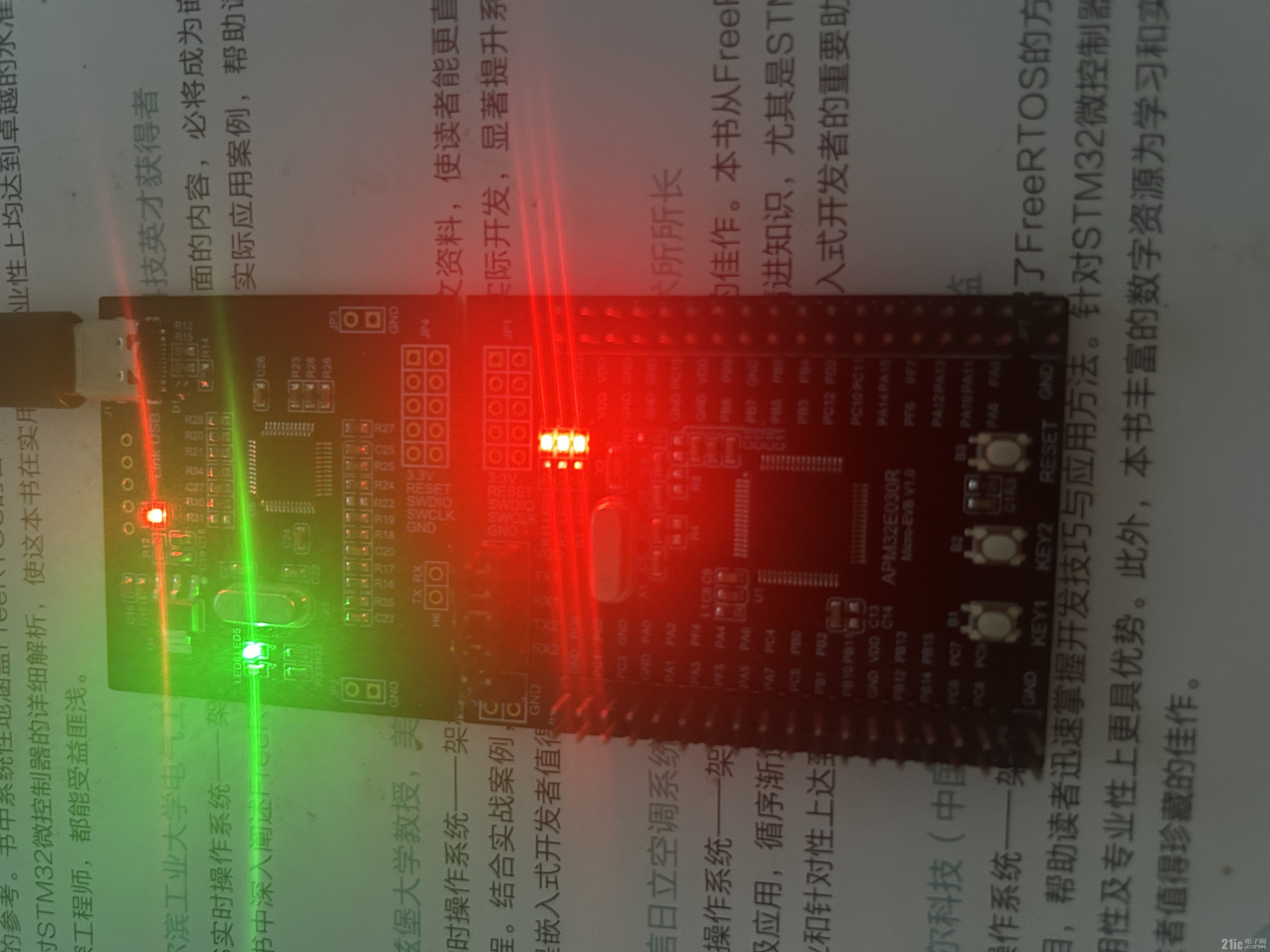

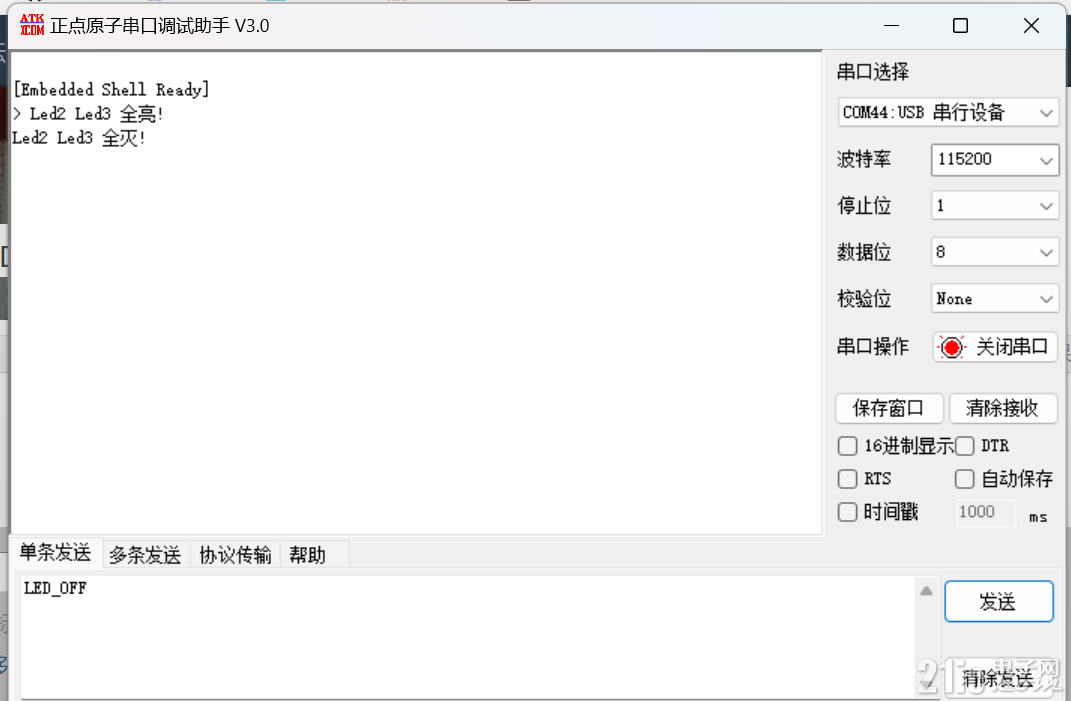

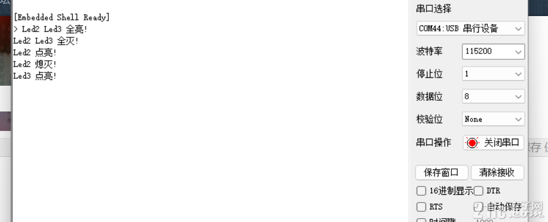

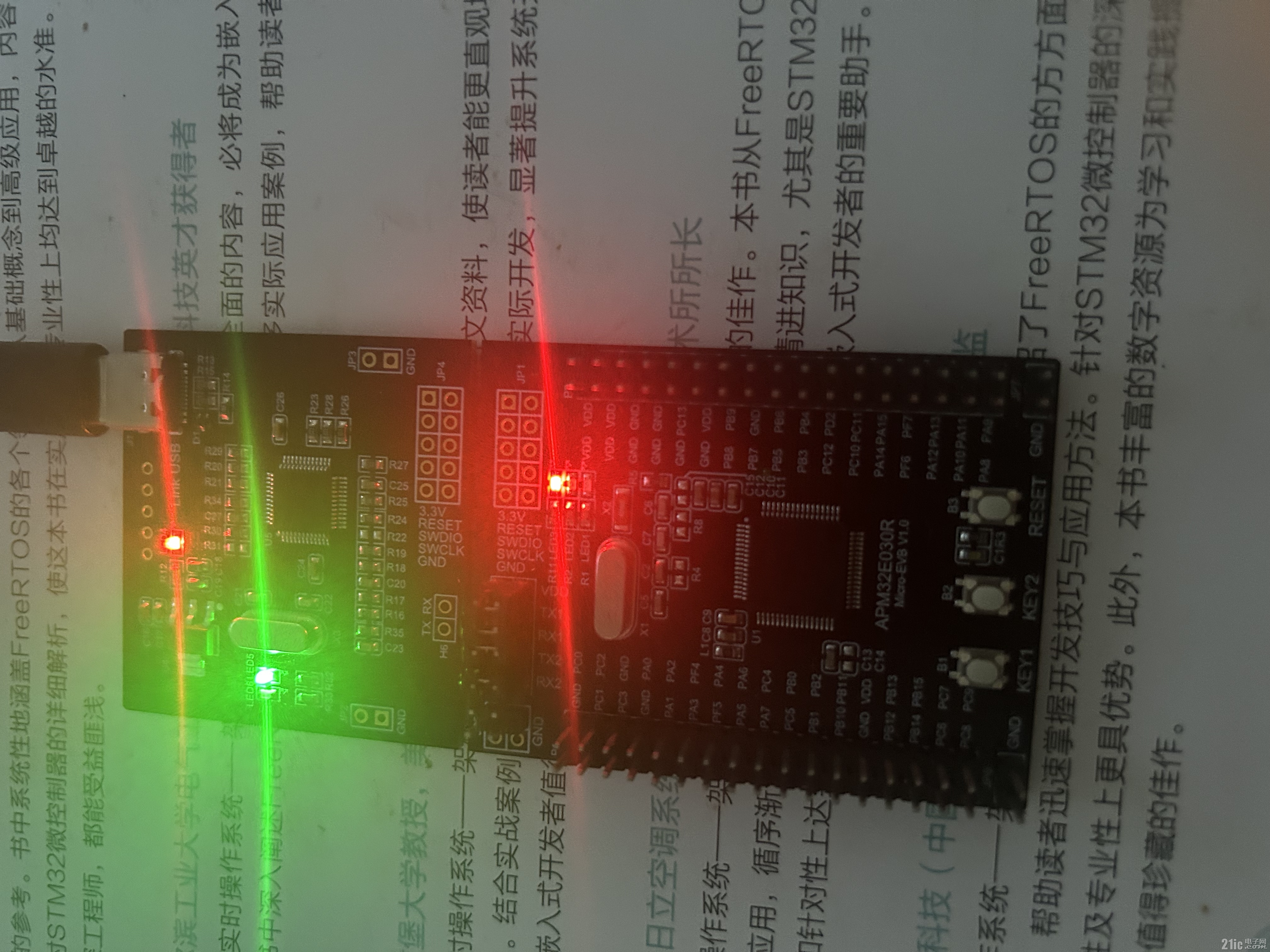

4.发送LED2_ON, LED2亮
5.发送LED2_OFF , LED2熄灭
6.发送LED3_ON,LED3亮

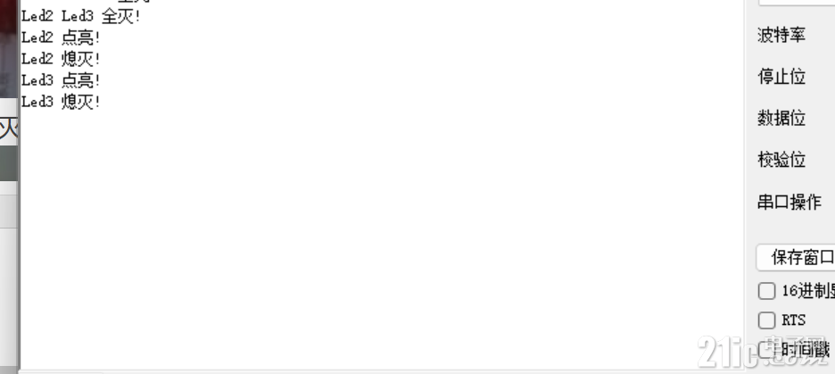

7.发送LED3_OFF,LED3熄灭
满足实验现象。
