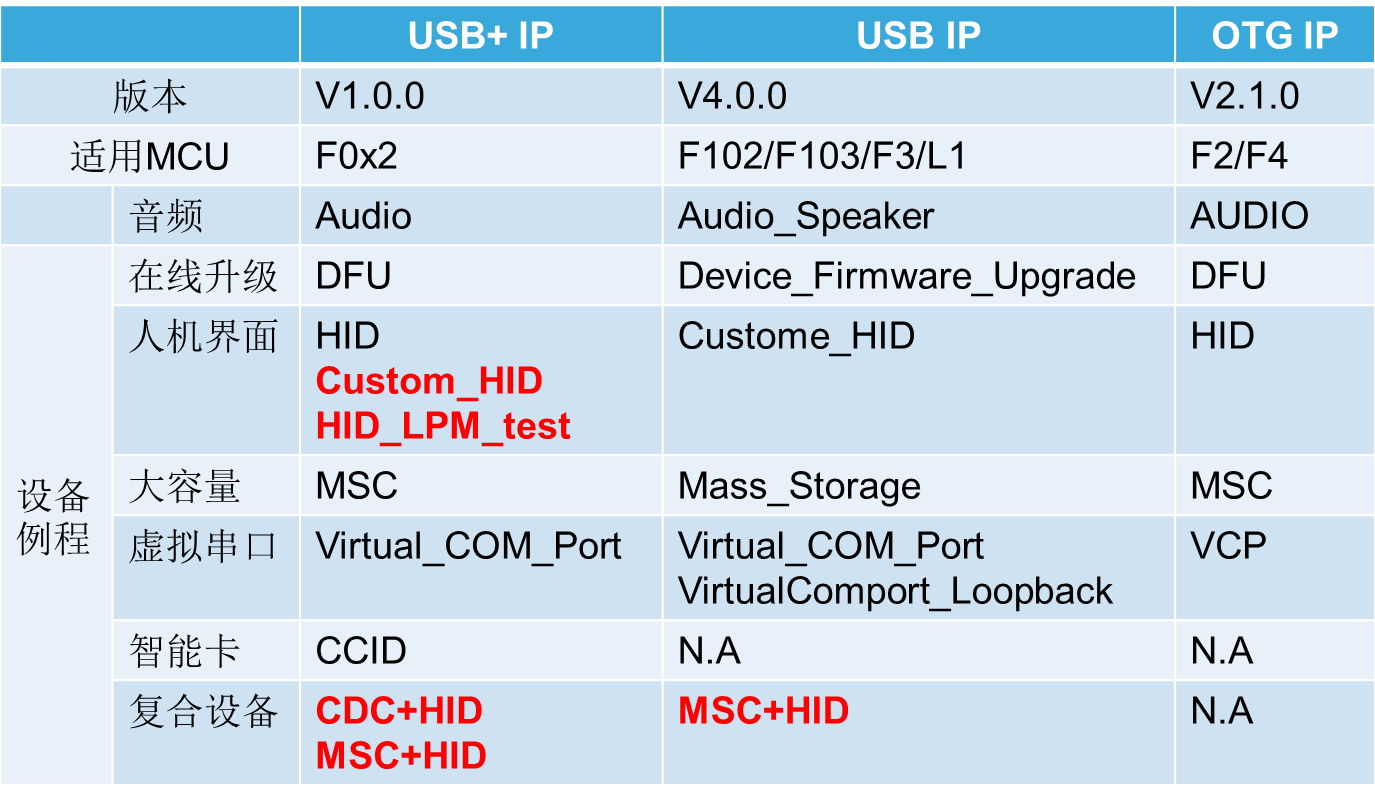

第一部分:STM32 USB demo
USB+ IP library @F0(STSW-STM32092)
页面链接
http://www.st.com/web/catalog/tools/FM147/CL1794/SC961/SS1743/PF257928
相关文档 UM1717
http://www.st.com/st-web-ui/static/active/en/resource/technical/document/user_manual/DM00104543.pdf
USB设备库下载
http://www.st.com/st-web-ui/static/active/en/st_prod_software_internet/resource/technical/software/firmware/stsw-stm32092.zip
实现的例程
Audio、CCID、MSC
Custom_HID、HID、HID_LPM_test
DFU、Virtual_COM_Port
CDC+HID复合设备、MSC_HID复合设备
USB IP library @F102-103/F3/32L
(STSW-STM32121)
页面链接
http://www.st.com/web/catalog/tools/FM147/CL1794/SC961/SS1743/PF258157
相关文档 UM0424
http://www.st.com/st-web-ui/static/active/en/resource/technical/document/user_manual/CD00158241.pdf
USB设备库下载
http://www.st.com/st-web-ui/static/active/en/st_prod_software_internet/resource/technical/software/firmware/stsw-stm32081.zip
实现的例程
Audio_Speaker、DFU、MSC
Joystick、Custom_HID、VCP
MSC+HID 复合设备
OTG IP library @F105-107/F2/F4(STSW-STM32046)
页面链接:
http://www.st.com/web/catalog/tools/FM147/CL1794/SC961/SS1743/PF257882
相关文档 UM1021
http://www.st.com/st-web-ui/static/active/en/resource/technical/document/user_manual/CD00289278.pdf
主机设备库下载:
http://www.st.com/st-web-ui/static/active/en/st_prod_software_internet/resource/technical/software/firmware/stm32_f105-07_f2_f4_usb-host-device_lib.zip
实现的设备例程
AUDIO、DFU、HID、MSC、VCP
Dual Core(FS IP和HS IP同时工作,分别实现MSC和HID设备)
实现的主机例程
MSC、HID
Dual Core(FS IP和HS IP同时工作,分别实现MSC和HID主机功能)
实现的双角色例程
DRD(根据插入电缆的不同,分别作MSC主机和MSC设备功能)
