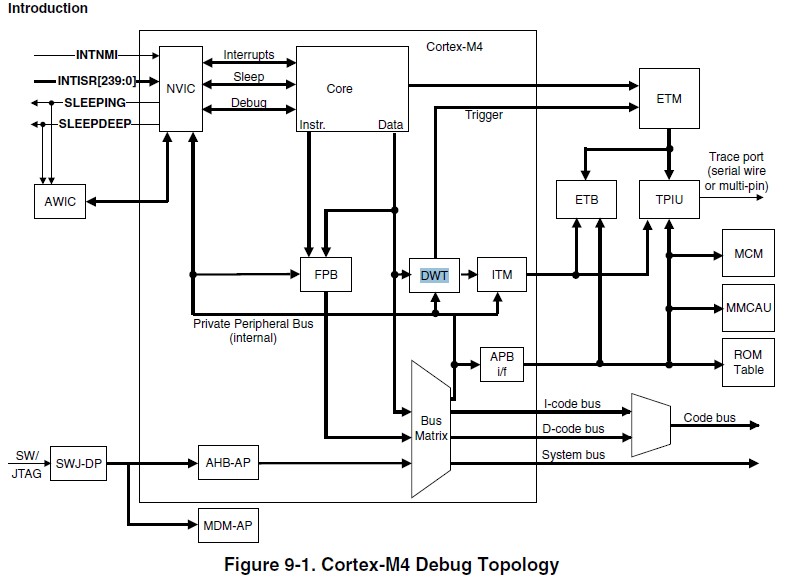

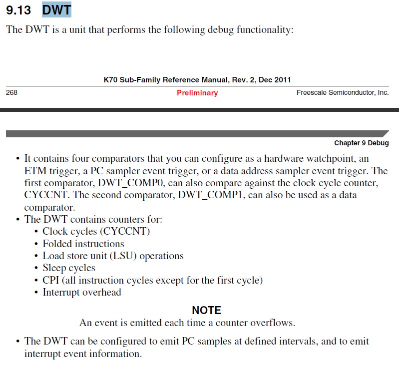

dwt简介Data Watchpoint and Trace (DWT)
Data Watchpoint and Trace (DWT) for real-time variable monitoring and PC-sampling, which can in turn be used to periodically output the PC or various CPU-internal counters, which can be used to obtain profiling information from the target.

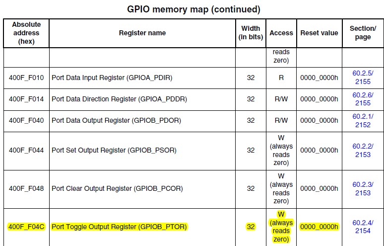

简单的说就是设置好触发源,在希望输出调试信息的地方操作触发源触发该中断。
