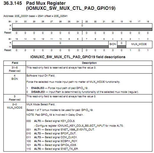

在linux或android系统中,假如我们要配置飞思卡尔IMX6处理器的GPIO管脚,比如是GPIO_19这个管脚,那么要像这样:
#define MX6Q_PAD_GPIO_19__GPIO_4_5                              \
                                (_MX6Q_PAD_GPIO_19__GPIO_4_5| MUX_PAD_CTRL(NO_PAD_CTRL))
其中_MX6Q_PAD_GPIO_19__GPIO_4_5定义为:
  #define _MX6Q_PAD_GPIO_19__GPIO_4_5         \
         IOMUX_PAD(0x0624, 0x0254, 5, 0x0000, 0, 0)
这个IOMUX_PAD宏是定义GPIO的关键宏,其原型为:
#define IOMUX_PAD(_pad_ctrl_ofs, _mux_ctrl_ofs, _mux_mode, _sel_input_ofs,
       _sel_input, _pad_ctrl)
IOMUX_PAD宏有6个参数,每个参数的意思是:

以下就GPIO_19这个管脚的配置进行说明:
1_pad_ctrl_ofs
找到数据手册:
从上图可知:_pad_ctrl_ofs = 0x624
2_mux_ctrl_ofs_mux_mode
找到数据手册的内容:
如上图,_mux_ctrl_ofs取值为0x254,_mux_mode范围为000~110
只有_mux_mode = 0时,_select_input_ofs和_select_input才有效,其余时候_select_input_ofs和_select_input 都为0。

综上所述,GPIO_19的配置宏定义如下:
  #define _MX6Q_PAD_GPIO_19__**_COL_5            \
         IOMUX_PAD(0x0624, 0x0254, 0, 0x08E8, 1, 0)
#define _MX6Q_PAD_GPIO_19__ENET_1588_EVENT0_OUT     \
         IOMUX_PAD(0x0624, 0x0254, 1, 0x0000, 0, 0)
  #define _MX6Q_PAD_GPIO_19__SPDIF_OUT1           \
         IOMUX_PAD(0x0624, 0x0254, 2, 0x0000, 0, 0)
  #define _MX6Q_PAD_GPIO_19__CCM_CLKO         \
         IOMUX_PAD(0x0624, 0x0254, 3, 0x0000, 0, 0)
  #define _MX6Q_PAD_GPIO_19__ECSPI1_RDY           \
         IOMUX_PAD(0x0624, 0x0254, 4, 0x0000, 0, 0)
  #define _MX6Q_PAD_GPIO_19__ENET_TX_ER           \
         IOMUX_PAD(0x0624, 0x0254, 6, 0x0000, 0, 0)
  #define _MX6Q_PAD_GPIO_19__SRC_INT_BOOT         \
         IOMUX_PAD(0x0624, 0x0254, 7, 0x0000, 0, 0)
以上的宏定义来自imx6的linux源码的arm/arch/palt-mxc/include/mach/iomux-mx6q.h
