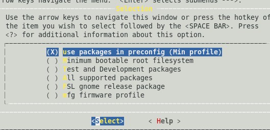

2.5 Build Manufacturing Firmware
Please refer 2.2 Installing and Building LTIB to setup ltib environment.
Configure Firmware build profile
./ltib --selectype
Choose correct item as below:
--- Choose the platform type
Selection (imx233/stmp3780) --->
--- Choose the packages profile
Selection (Updater profile for mx233) --->
After ltib complete build. Updater.sb will be created
i.MX 23 linux_BSP_UserGuide 上面是这么写的可是我执行的时候发现第二个没有文档上面说的选项,图下面给出

FSL_TICS_Rita 发表于 2014-9-18 10:32 | 显示全部楼层
小李菜刀 发表于 2014-9-16 15:18
楼主你好,图中的选项建议你选择最后一个mfg firmware profile。
