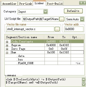

这是我的实验例程,板子是stm8s207s6,函数的意思很明确,不再解释,下面开始解析配置步骤!
@code
All the functions defined below must be executed from RAM exclusively, except
for the FLASH_WaitForLastOperation function which can be executed from Flash.
Steps of the execution from RAM differs from one toolchain to another:
- For Cosmic Compiler:
    1- Define a segment FLASH_CODE by the mean of " #pragma section (FLASH_CODE)".
    This segment is defined in the stm8s_flash.c file.
  2- Uncomment the "#define RAM_EXECUTION  (1)" line in the stm8s.h file,
    or define it in Cosmic compiler preprocessor to enable the FLASH_CODE segment
   definition.
  3- In STVD Select Project\Settings\Linker\Category "input" and in the RAM section
    add the FLASH_CODE segment with "-ic" options.
  4- In main.c file call the _fctcpy() function with first segment character as
    parameter "_fctcpy('F');" to load the declared moveable code segment
    (FLASH_CODE) in RAM before execution.
  5- By default the _fctcpy function is packaged in the Cosmic machine library,
    so the function prototype "int _fctcopy(char name);" must be added in main.c
    file.
解析(stvd+cosmic+4.0官方库函数):
  第一步:#pragma section (FLASH_CODE)库函数stm8s_flash.c中代码第520行已经有了,并且没被注释掉,原型为:
#if defined (_COSMIC_) && defined (RAM_EXECUTION)
#endif  /* _COSMIC_ && RAM_EXECUTION */
IN_RAM(FLASH_Status_TypeDef FLASH_WaitForLastOperation(FLASH_MemType_TypeDef FLASH_MemType))
      ......//库函数代码
IN_RAM(void FLASH_EraseBlock(uint16_t BlockNum, FLASH_MemType_TypeDef FLASH_MemType))
    ......库函数代码
IN_RAM(void FLASH_ProgramBlock(uint16_t BlockNum, FLASH_MemType_TypeDef FLASH_MemType,
                        FLASH_ProgramMode_TypeDef FLASH_ProgMode, uint8_t *Buffer))
     ......//库函数代码
/* End of FLASH_CODE section */
#pragma section ()
第二步:打开宏开关#define RAM_EXECUTION  (1),在stm8s.h中
#if !defined (RAM_EXECUTION)
#endif /* RAM_EXECUTION */
第三步:工程设置
第四步:在main.c中声明int _fctcpy(char name);在主函数运行前调用_fctcpy('F');具体操作可参考主函数代码
      这几步都配置完成后就可以编译通过了,然后烧录调试完美块编程,包括快擦除等,已经验证!

其实这个说明STM8的库函数就有说大家不去看而已。不过我看到了最终还是没编译过,为啥就是 设置FLASH_CODE选项时少了FLASH_CODE前面那个点号。。。。就没编过。应该是自己粗心了没多想。不过也搞了好几天啊~~~~
