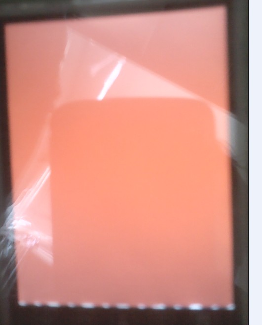

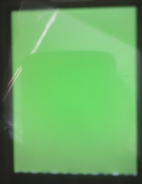

这个是用的一个240*320的彩屏,
采用的是并口数据接入。
下面的是刷屏的程序 分别显示三种不同的颜色

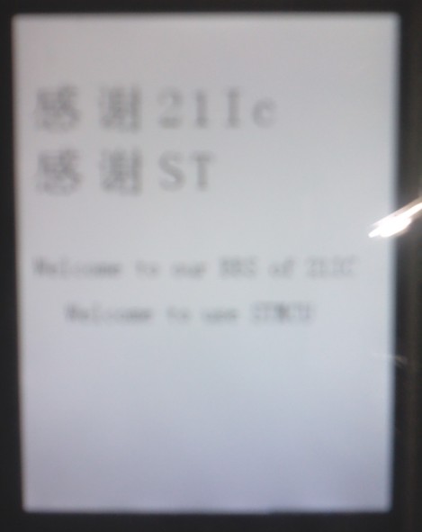

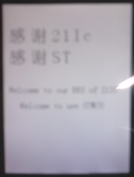

下面开始进入整体 显示一个 感谢21ic 感谢st 的字符

这是主函数了
int main()
    init_Gpio();
    LCD_Init();          //TFT???
     Pant(0xff,0xff);     //TFT??
    LCD_CS0;
    hanzi32_32(40,10,gan,0x00,0xffff);
    hanzi32_32(40,50,xie,0x00,0xffff);
    zf32_32(40,90,m1,0x00,0xffff);
    zf32_32(40,110,m2,0x00,0xffff);
    zf32_32(40,130,m3,0x00,0xffff);
    zf32_32(40,150,m4,0x00,0xffff);
    hanzi32_32(80,10,gan,0x00,0xffff);
    hanzi32_32(80,50,xie,0x00,0xffff);
    zf32_32(80,90,m5,0x00,0xffff);
    zf32_32(80,110,m6,0x00,0xffff);
    printf_string(150,10,"Welcome to our BBS of 21IC",0x00,0xffff);
    printf_string(180,30,"Welcome to use STMCU",0x00,0xffff);
    while(1);
