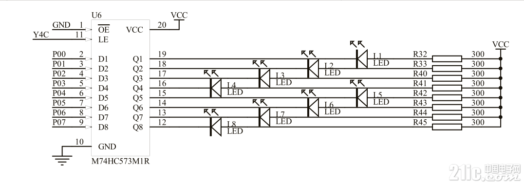

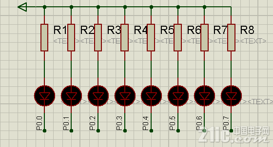

LED部分电路与proteus仿真电路以及相关代码如下。
             CT107平台LED原理图
             proteus仿真LED电路
#include "led.h"
unsigned char led_tab1[]={0xfe,0xfc,0xf8,0xf0,0xe0,0xc0,0x80,0x00};
unsigned char led_tab2[]={0x01,0x03,0x07,0x0f,0x1f,0x3f,0x7f,0xff};
void led_liushui()
        unsigned char i;
        for(i=0;i<8;i++)
          P2=0x80;
    P0=led_tab1;
          P2=0x1f;
    delay_ms(500);
void led_off()
  unsigned char i;
        for(i=0;i<8;i++)
          P2=0x80;
    P0=led_tab2;
          P2=0x1f;
    delay_ms(500);
 楼主| 一路向北lm 发表于 2018-3-31 12:47 | 显示全部楼层

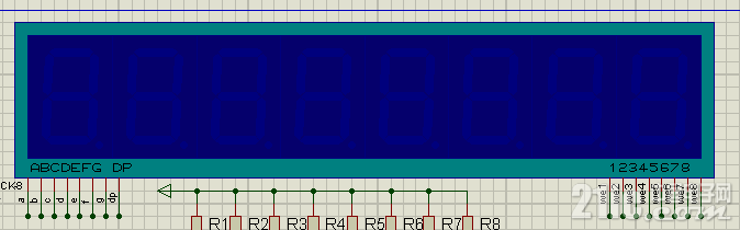

数码管部分电路与proteus仿真电路以及相关代码如下。
           CT107平台数码管模块
              proteus仿真电路
#include "smg.h"
unsigned char smg_du_tab[]={0xc0,0xf9,0xa4,0xb0,0x99,0x92,0x82,0xf8,0x80,0x90,0xbf,0xff};
unsigned char smg_we_tab1[]={0x01,0x03,0x07,0x0f,0x1f,0x3f,0x7f,0xff};
unsigned char smg_we_tab2[]={0xfe,0xfc,0xf8,0xf0,0xe0,0xc0,0x80,0x00};
unsigned char yi,er,san,si,wu,liu,qi,ba;
void smg_liushui()
        unsigned char i;
  for(i=0;i<8;i++)
          P2=0xc0;
          P0=smg_we_tab1;
          P2=0x1f;
          P0=0xff;
          P2=0xe0;
    P0=0x00;
          P2=0x1f;
          P0=0x00;
                delay_ms(500);
void smg_off()
   unsigned char i;
  for(i=0;i<8;i++)
          P2=0xc0;
          P0=smg_we_tab2;
          P2=0x1f;
          P0=0xff;
          P2=0xe0;
    P0=0x00;
          P2=0x1f;
          P0=0x00;
                delay_ms(500);
void display1(unsigned char yi, unsigned char er)
    P2=0xc0;
          P0=0x01;
          P2=0x1f;
          P0=0xff;
          P2=0xe0;
    P0=smg_du_tab[yi];
          P2=0x1f;
          P0=0x00;
          delay_ms(1);
          P2=0xc0;
          P0=0x02;
          P2=0x1f;
          P0=0xff;
          P2=0xe0;
    P0=smg_du_tab[er];
          P2=0x1f;
          P0=0x00;
          delay_ms(1);
void display2(unsigned char san,unsigned char si)
    P2=0xc0;
          P0=0x04;
          P2=0x1f;
          P0=0xff;
          P2=0xe0;
    P0=smg_du_tab[san];
          P2=0x1f;
          P0=0x00;
          delay_ms(1);
          P2=0xc0;
          P0=0x08;
          P2=0x1f;
          P0=0xff;
          P2=0xe0;
    P0=smg_du_tab[si];
          P2=0x1f;
          P0=0x00;
          delay_ms(1);
void display3(unsigned char wu, unsigned char liu)
    P2=0xc0;
          P0=0x10;
          P2=0x1f;
          P0=0xff;
          P2=0xe0;
    P0=smg_du_tab[wu];
          P2=0x1f;
          P0=0x00;
          delay_ms(1);
          P2=0xc0;
          P0=0x20;
          P2=0x1f;
          P0=0xff;
          P2=0xe0;
    P0=smg_du_tab[liu];
          P2=0x1f;
          P0=0x00;
          delay_ms(1);
void display4(unsigned char qi, unsigned char ba)
    P2=0xc0;
          P0=0x40;
          P2=0x1f;
          P0=0xff;
          P2=0xe0;
    P0=smg_du_tab[qi];
          P2=0x1f;
          P0=0x00;
          delay_ms(1);
          P2=0xc0;
          P0=0x80;
          P2=0x1f;
          P0=0xff;
          P2=0xe0;
    P0=smg_du_tab[ba];
          P2=0x1f;
          P0=0x00;
          delay_ms(1);

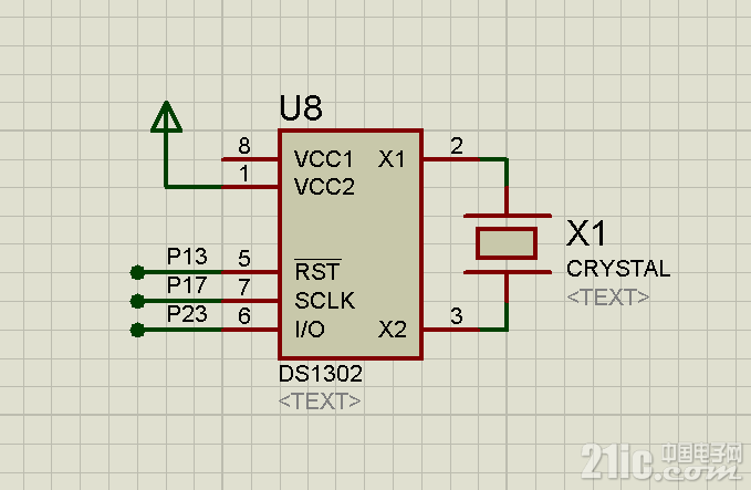

ds1302电路和proteus仿真电路以及相关代码
        CT107平台ds1302电路
          proteus仿真电路
#include "ds1302.h"
unsigned char shi,fen,miao;
void Write_Ds1302_Byte(unsigned char dat)
        unsigned char i;
        SCK = 0;
        for (i=0;i<8;i++)
                if (dat & 0x01)
                        SDA_SET;
                else
                        SDA_CLR;
                SCK_SET;
                SCK_CLR;
                dat = dat >> 1;
unsigned char Read_Ds1302_Byte(void)
        unsigned char i, dat=0;
        for (i=0;i<8;i++)
                dat = dat >> 1;
                if (SDA_R)
                        dat |= 0x80;
                else
                        dat &= 0x7F;
                SCK_SET;
                SCK_CLR;
        return dat;
void Ds1302_Single_Byte_Write(unsigned char addr, unsigned char dat)
        RST_CLR;
        SCK_CLR;
        RST_SET;
        addr = addr & 0xFE;
        Write_Ds1302_Byte(addr);
        Write_Ds1302_Byte(dat);
        RST_CLR;
unsigned char Ds1302_Single_Byte_Read(unsigned char addr)
        unsigned char temp;
        RST_CLR;
        SCK_CLR;
        RST_SET;
        addr = addr | 0x01;
        temp=Read_Ds1302_Byte();
        RST_CLR;
        SDA_CLR;
        return temp;
unsigned char dat_bcd(unsigned char dat)
unsigned char dat1,dat2;
dat1=dat/10;
dat2=dat%10;
dat=dat1*16+dat2;
return dat;
unsigned char bcd_dat(unsigned char dat)
dat1=dat/16;
dat2=dat%16;
dat=dat1*10+dat2;
return dat;
void ds1302init()
Ds1302_Single_Byte_Write(0x8e,0x00);
Ds1302_Single_Byte_Write(0x80,dat_bcd(00));
Ds1302_Single_Byte_Write(0x82,dat_bcd(00));
Ds1302_Single_Byte_Write(0x84,dat_bcd(00));
Ds1302_Single_Byte_Write(0x8e,0x80);
void gettime()
miao=bcd_dat(Ds1302_Single_Byte_Read(0x81));
fen=bcd_dat(Ds1302_Single_Byte_Read(0x83));
shi=bcd_dat(Ds1302_Single_Byte_Read(0x85));
