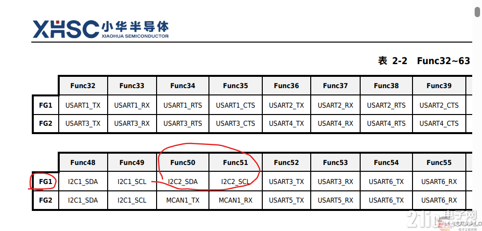

数据手册中说明了 i2c 2 的配置功能号是SDA为50,SCL为51,如果是I2C1 就是48 和49,对应时钟是FG1

全局宏定义:
//全局宏定义
/* Define port and pin for SDA and SCL */
#define I2C_SDA_PORT        (GPIO_PORT_D)//类似HAL库的配置
#define I2C_SDA_PIN         (GPIO_PIN_00)
#define I2C_SCL_PORT        (GPIO_PORT_D)
#define I2C_SCL_PIN         (GPIO_PIN_01)
#define I2C_SDA_FUNC        (GPIO_FUNC_50)        //pin脚功能配置号
#define I2C_SCL_FUNC        (GPIO_FUNC_51)        //详情见数据手册引脚配置页
/* I2C unit define */
#define I2C_UNIT            (CM_I2C2)                                                //硬件I2C地址
#define I2C_FCG             (FCG1_PERIPH_I2C2)        //开启时钟
* @defgroup I2C_Configuration BSP I2C Configuration
#define I2C_BAUDRATE      (400000UL) //I2C波特率配置
#define I2C_TIMEOUT       (0x64U)                 //
t60yz|  楼主 | 2024-2-28 19:31 | 只看该作者
硬件I2C 的GPIO口配置
* @brief   I2C_Init0 配置gpio口功能,主要是功能号I2C_SCL_FUNC和SDA_FUNC,要按照数据手册写
* @param
* @retval LL_OK
static void I2C_GPIO_Init(void)
    stc_gpio_init_t stcGpioInit;
    /* Configuration I2C GPIO */
    (void)GPIO_StructInit(&stcGpioInit);
    (void)GPIO_Init(I2C_SCL_PORT, I2C_SCL_PIN, &stcGpioInit);//初始化gpio
    (void)GPIO_Init(I2C_SDA_PORT, I2C_SDA_PIN, &stcGpioInit);
    GPIO_SetFunc(I2C_SCL_PORT, I2C_SCL_PIN, I2C_SCL_FUNC);//配置功能为SCL
    GPIO_SetFunc(I2C_SDA_PORT, I2C_SDA_PIN, I2C_SDA_FUNC);//SDA
    /* Enable I2C Peripheral*/
                FCG_Fcg1PeriphClockCmd(I2C_FCG, ENABLE);//开启外设时钟
    (void)I2C_Init(I2C_UNIT);//I2C初始化函数

t60yz|  楼主 | 2024-2-28 19:32 | 只看该作者

* @addtogroup HC32F448_DDL_Examples
