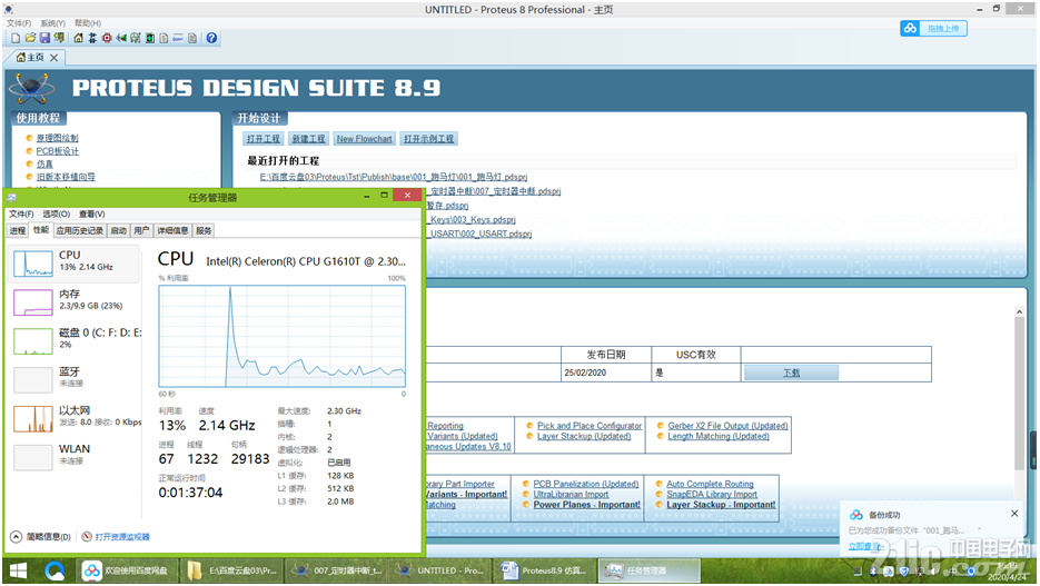

二,调整虚拟器件,另存工程文件。(如下图2,3,4所示)
图2
图3
图4

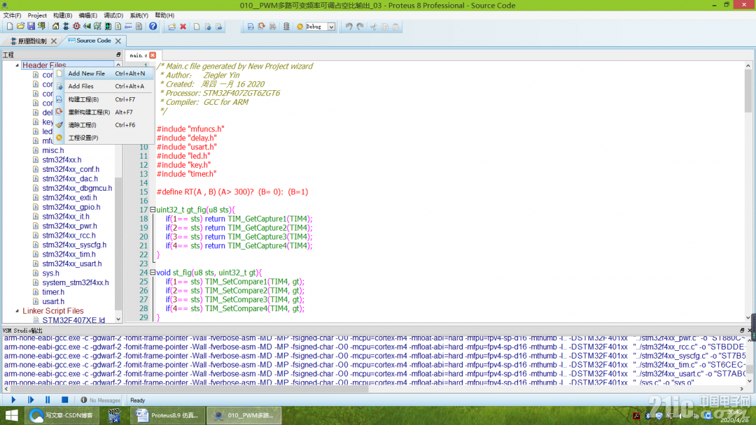

三,点击Source Code标签。(如下图5所示)
图5

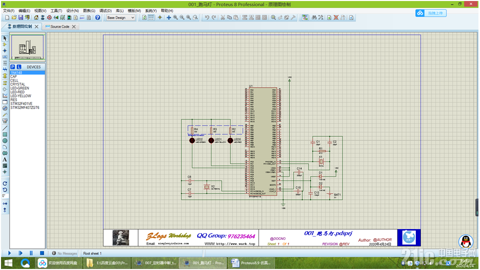

四,编辑main.c,timer.c,timer.h, key.c,key.h, led.c,led.h 代码如Proteus8.9 仿真STM32407ZGT6系列001(如下图6所示)
图6

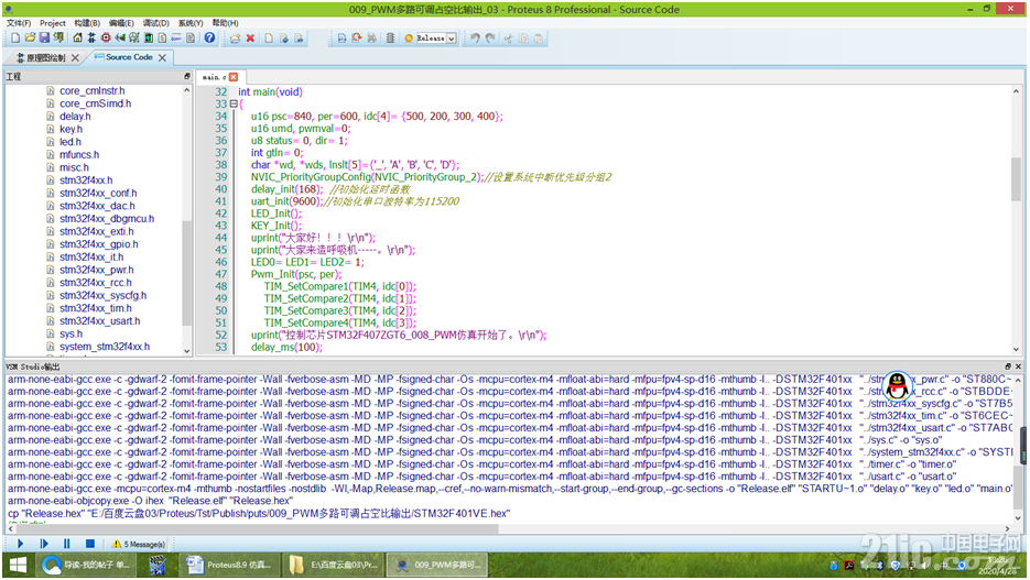

五,Main.c 代码:
/* Main.c file generated by New Project wizard
* Author:   Ziegler Yin
* Created:   周四 一月 16 2020
* Processor: STM32F407ZGT6ZGT6
* Compiler:  GCC for ARM
#include "mfuncs.h"
#include "delay.h"
#include "usart.h"
#include "led.h"
#include "key.h"
#include "timer.h"
#define RT(A , B) (A> 300)?  (B= 0):  (B=1)
uint32_t gt_fig(u8 sts){
        if(1== sts) return TIM_GetCapture1(TIM4);
        if(2== sts) return TIM_GetCapture2(TIM4);
        if(3== sts) return TIM_GetCapture3(TIM4);
        if(4== sts) return TIM_GetCapture4(TIM4);
void st_fig(u8 sts, uint32_t gt){
        if(1== sts) TIM_SetCompare1(TIM4, gt);
        if(2== sts) TIM_SetCompare2(TIM4, gt);
        if(3== sts) TIM_SetCompare3(TIM4, gt);
        if(4== sts) TIM_SetCompare4(TIM4, gt);
void new_Pwm(u16 *tmbuf, u16 * mdc) {
        Pwm_Init(*(tmbuf+0), *(tmbuf+1));
        TIM_SetCompare1(TIM4, mdc[0]);
        TIM_SetCompare2(TIM4, mdc[1]);
        TIM_SetCompare3(TIM4, mdc[2]);
        Pwm_Init3(*(tmbuf+2), *(tmbuf+3));
        TIM_SetCompare2(TIM3, mdc[1]);
int main(void)
        u16 psc=840, per=600, idc[4]= {500, 200, 300, 400};
        u16 umd, pwmval=0, tm43[2][2]= {840, 600, 1680, 1200};
        u8 status= 0, dir= 1, chgFry[1]= {0, 0};
        int gtln= 0;
        char *wd, *wds, *lnslt[7]={"未选", "A线路", "B线路", "C线路", "D线路", "变频1-A,B,C倍频或初始状态", "变频2-D四倍频或初始状态"};
        NVIC_PriorityGroupConfig(NVIC_PriorityGroup_2);//设置系统中断优先级分组2
        delay_init(168);  //初始化延时函数
        uart_init(9600);//初始化串口波特率为115200
    LED_Init();
    KEY_Init();
        uprint("大家好!!!\r\n");
        uprint("大家来造呼吸机-----。\r\n");
                        gtln= nmtoa(wd, 10, psc);
                        uprint(wd); uprint("\r\n");
                        gtln= nmtoa(wd, 10, (psc+10000));
        LED0= LED1= LED2= 1;
        chgFry[0]= 0;
        chgFry[1]= 4;
        new_Pwm(tm43, idc);
        uprint("控制芯片STM32F407ZGT6_008_PWM仿真开始了。\r\n");
        delay_ms(100);
   while(1)
                wd= lnslt[status]; ;
                uprint("Arm运行时......占空比:\r\n");
                uprint(wd);
                uprint("线路可调整状态:\r\n");
                if(1==ReadKey(GPIOC, 0x0080)) {
                        status++;
                   delay_ms(20);
                        if(status> 6) status= 0;
                        uprint("线路调整状态......占空比");
                        uprint(wd);
                if(1==ReadKey(GPIOC, 0x0010)) {
                        LED0= 1;
                        pwmval= gt_fig(status);
                        gtln= nmtoa(wds, 10, pwmval);
                        if(status>0){
                                if(per< (pwmval+ 50)) {
                                                uprint("线路调整, 占空值到达最高值 ......\r\n");
                                                st_fig(status, (per+ 1));
                                else{
                                        LED0= 1;
                                        umd= pwmval +50;
                                        uprint("线路调整, 占空值由 ");
                                        uprint(wds);
                                        uprint(" 增加50 至");
                                        uprint(numtoa(10, umd));
                                        uprint(" ...\r\n ");
                                        st_fig(status, umd);
                if(1==ReadKey(GPIOC, 0x0020)) {
                        LED1= 1;
                        if(status==5) {
                                if(chgFry[0]==0) {
                                        chgFry[0]= 2;
                                        tm43[0][0]= 1680;
                                        new_Pwm(tm43, idc);
                                        uprint("线路A,B,C频率调整到倍频...\r\n");
                                        delay_ms(200);
                                else{
                                        chgFry[0]= 0;
                                        tm43[0][0]= 840;
                                        new_Pwm(tm43, idc);
                                        uprint("线路A,B,C频率调整到初始状态...\r\n");
                                        delay_ms(200);
                        if(status==6) {
                                if(chgFry[1]==0) {
                                        chgFry[1]= 4;
                                        tm43[1][0]= 1680; tm43[1][1]= 1200;
                                        new_Pwm(tm43, idc);
                                        uprint("线路D频率调整到四倍频...\r\n");
                                        delay_ms(200);
                                else{
                                        chgFry[1]= 0;
                                        tm43[1][0]= 840; tm43[1][1]= 600;
                                        new_Pwm(tm43, idc);
                                        uprint("线路D频率调整到初始状态...\r\n");
                                        delay_ms(200);
                    delay_ms(20);
                        uprint("Arm运行时......占空比");
                        uprint(wd);
                        uprint("线路调整, 由 ");
                        uprint(wds);
                        uprint(" 清零 ");
                        st_fig(status, 0);
                if(1==ReadKey(GPIOC, 0x0040)) {
                        LED2= 1;
                        if(pwmval> 50) {
                        umd= pwmval -50;
                        uprint(wds);
                        uprint(" 减少50 至 ");
                        else {
                                umd= 1;
                                uprint("线路调整, 占空值到达最低值 ......\r\n");
                                st_fig(status, 1);
                LED0= LED1= LED2= 0;
                delay_ms(100);

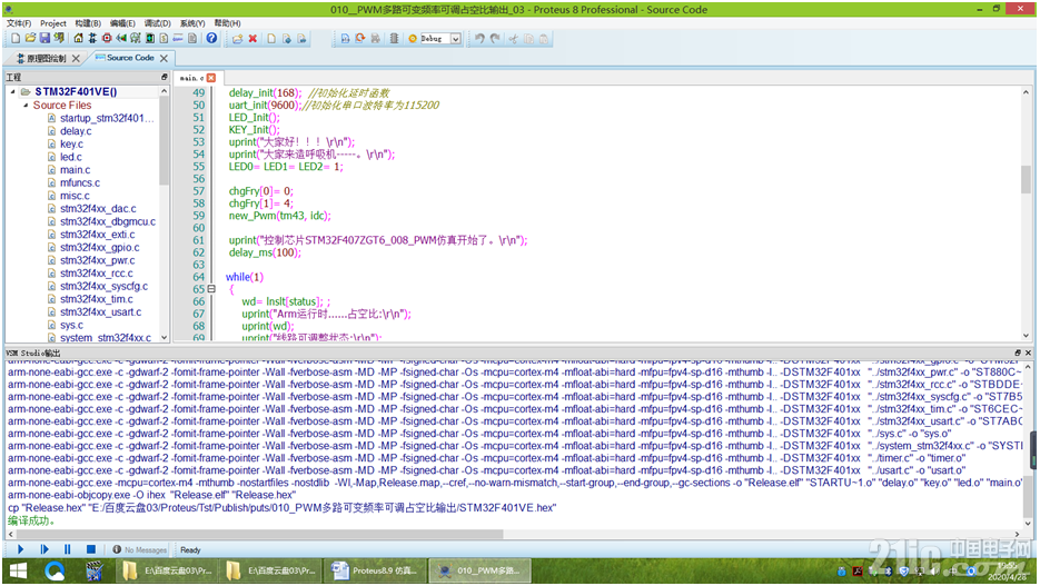

六,点击构建工程按钮,编译工程。(如下图7所示)
图7

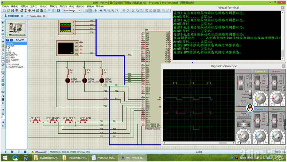

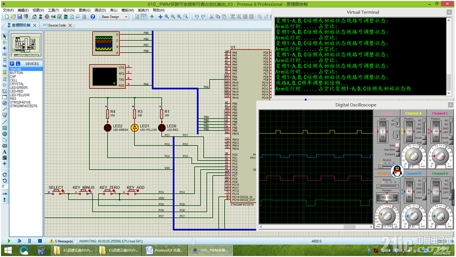

七,点击窗口左下方仿真按钮,可见红,黄,绿灯点亮后一会灭,仿真开始,按下SELECT按钮,选择"变频1-A,B,C倍频或初始状态", "变频2-D四倍频或初始状态",按下按下KEY_ZERO按钮,倍频, 四倍频或初始状态。占空比的调试,参见:博主的Proteus8.9 仿真STM32407ZGT6系列009_PWM多路可调占空比输出文。虚拟串口,示波器将的状态变化显示在屏。 (如下图8,9,10,11所示)
图8
图9
图10
图11
八,选择release,点击构建工程按钮,编译工程生成Hex文件。(如下图12所示)
图12
