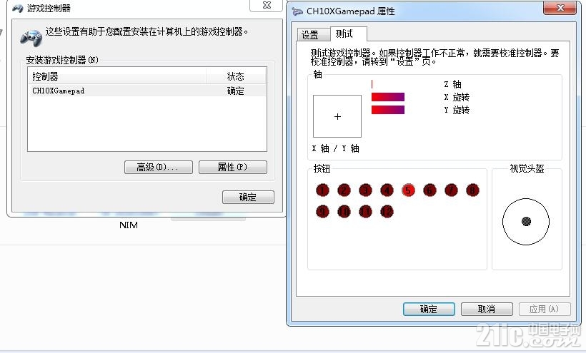

    看了一下USBDevice设备例子,改了一个USBHID的设备。实现了键盘鼠标手柄三合一例子。默认开始是手柄,可以通过手柄输出切换成键盘或者鼠标输出数据。用PB12,PB13,PB14,PB15做按键输入模拟。

  1.         if(ctrl_data == 0x80)
  2.         {
  3.             if(!GPIO_ReadInputDataBit(GPIOB,GPIO_Pin_12))
  4.             {
  5.                 pEP1_IN_DataBuf[6] |= 0x01;
  6.             }else
  7.             {
  8.                 pEP1_IN_DataBuf[6] &= ~0x01;
  9.             }
  10.             if(!GPIO_ReadInputDataBit(GPIOB,GPIO_Pin_13))
  11.             {
  12.                 pEP1_IN_DataBuf[6] |= 0x02;
  13.             }else
  14.             {
  15.                 pEP1_IN_DataBuf[6] &= ~0x02;
  16.             }
  17.             if(!GPIO_ReadInputDataBit(GPIOB,GPIO_Pin_14))
  18.             {
  19.                 pEP1_IN_DataBuf[6] |= 0x04;
  20.             }else
  21.             {
  22.                 pEP1_IN_DataBuf[6] &= ~0x04;
  23.             }
  24.             if(!GPIO_ReadInputDataBit(GPIOB,GPIO_Pin_15))
  25.             {
  26.                 pEP1_IN_DataBuf[6] |= 0x08;
  27.             }else
  28.             {
  29.                 pEP1_IN_DataBuf[6] &= ~0x08;
  30.             }
  31.             DevEP1_IN_Deal( 7 );
  32.         }else if(ctrl_data == 0x20)
  33.         {
  34.             if(!GPIO_ReadInputDataBit(GPIOB,GPIO_Pin_12))
  35.             {
  36.                 pEP2_IN_DataBuf[0] |= 0x01;
  37.             }else
  38.             {
  39.                 pEP2_IN_DataBuf[0] &= ~0x01;
  40.             }
  41.             if(!GPIO_ReadInputDataBit(GPIOB,GPIO_Pin_13))
  42.             {
  43.                 pEP2_IN_DataBuf[0] |= 0x02;
  44.             }else
  45.             {
  46.                 pEP2_IN_DataBuf[0] &= ~0x02;
  47.             }
  48.             if(!GPIO_ReadInputDataBit(GPIOB,GPIO_Pin_14))
  49.             {
  50.                 pEP2_IN_DataBuf[0] |= 0x04;
  51.             }else
  52.             {
  53.                 pEP2_IN_DataBuf[0] &= ~0x04;
  54.             }
  55.             if(!GPIO_ReadInputDataBit(GPIOB,GPIO_Pin_15))
  56.             {
  57.                 pEP2_IN_DataBuf[0] |= 0x08;
  58.             }else
  59.             {
  60.                 pEP2_IN_DataBuf[0] &= ~0x08;
  61.             }
  62.             DevEP2_IN_Deal( 8 );
  63.         }else if(ctrl_data == 0x40)//
  64.         {
  65.             if(!GPIO_ReadInputDataBit(GPIOB,GPIO_Pin_12))
  66.             {
  67.                 pEP3_IN_DataBuf[1] = 1;
  68.             }else if(!GPIO_ReadInputDataBit(GPIOB,GPIO_Pin_13))
  69.             {
  70.                 pEP3_IN_DataBuf[1] = 0xff;
  71.             }else
  72.             {
  73.                 pEP3_IN_DataBuf[1] = 0;
  74.             }
  75.             if(!GPIO_ReadInputDataBit(GPIOB,GPIO_Pin_14))
  76.             {
  77.                 pEP3_IN_DataBuf[2] = 1;
  78.             }else if(!GPIO_ReadInputDataBit(GPIOB,GPIO_Pin_15))
  79.             {
  80.                 pEP3_IN_DataBuf[2] = 0xff;
  81.             }else
  82.             {
  83.                 pEP3_IN_DataBuf[2] = 0;
  84.             }
  85.             DevEP3_IN_Deal( 4 );
  86.         }
  87.         Delay_Ms(10);
  88.     }
具体输出控制在:
  1. void DevEP1_OUT_Deal( UINT8 l )
  3.     ctrl_data = pEP1_OUT_DataBuf[0];
  4.     if(pEP1_OUT_DataBuf[0] & 0x01)
  5.     {
  6.         GPIO_WriteBit(GPIOA,  GPIO_Pin_0, Bit_SET);
  7.     }else
  8.     {
  9.         GPIO_WriteBit(GPIOA,  GPIO_Pin_0, Bit_RESET );
  10.     }
  11.     if(pEP1_OUT_DataBuf[0] & 0x02)
  12.     {
  13.         GPIO_WriteBit(GPIOA,  GPIO_Pin_1, Bit_SET );
  14.     }else
  15.     {
  16.         GPIO_WriteBit(GPIOA,  GPIO_Pin_1, Bit_RESET );
  17.     }
  18. }
下面是测试程序:
