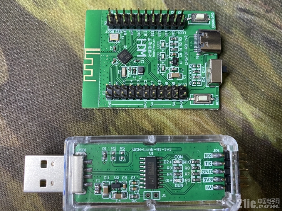

上周已申请的 CH573蓝牙开发板 已收到
开始撸 RISC-V ...

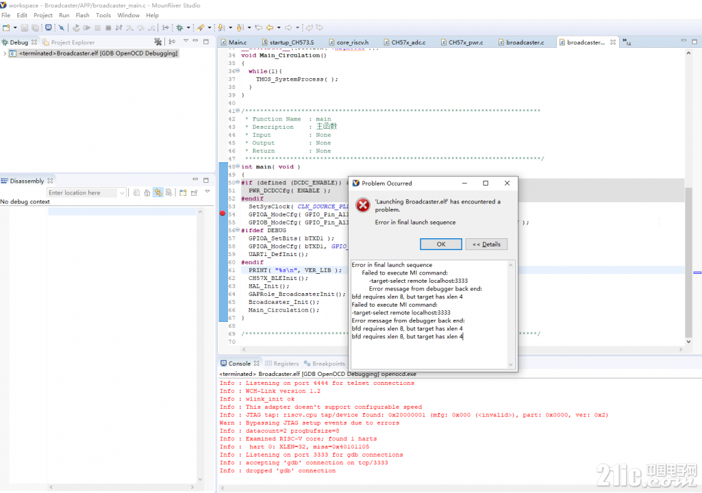

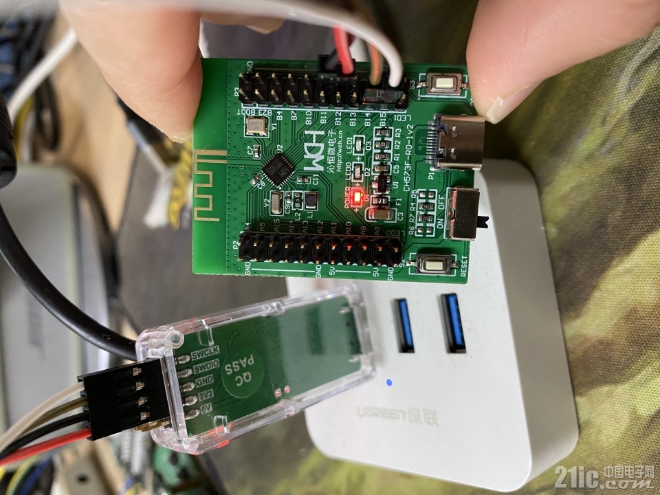

接着这个帖子,顺便问一下 CH573EVT 板子仿真的问题
参考链接 http://www.wch.cn/bbs/thread-71545-1.html 开启仿真及板子接线
但是仿真出现如下错误
Error in final launch sequence
Failed to execute MI command:
-target-select remote localhost:3333
Error message from debugger back end:
bfd requires xlen 8, but target has xlen 4
Open On-Chip Debugger 0.10.0+dev-gb0ae840-dirty (2020-10-26-10:50)
Licensed under GNU GPL v2
For bug reports, read
        http://openocd.org/doc/doxygen/bugs.html
Info : only one transport option; autoselect 'jtag'
Ready for Remote Connections
Started by GNU MCU Eclipse
Info : Listening on port 6666 for tcl connections
Info : Listening on port 4444 for telnet connections
Info : WCH-Link version 1.2
Info : wlink_init ok
Info : This adapter doesn't support configurable speed
Info : JTAG tap: riscv.cpu tap/device found: 0x20000001 (mfg: 0x000 (<invalid>), part: 0x0000, ver: 0x2)
Warn : Bypassing JTAG setup events due to errors
Info : datacount=2 progbufsize=8
Info : Examined RISC-V core; found 1 harts
Info :  hart 0: XLEN=32, misa=0x40101105
Info : Listening on port 3333 for gdb connections
Info : accepting 'gdb' connection on tcp/3333
Info : dropped 'gdb' connection
请遇到的朋友或者原厂帮忙解答一下.

YaoXG 发表于 2021-3-8 08:50 | 显示全部楼层
参考链接 http://www.wch.cn/bbs/thread-71545-1.html  ...
https://bbs.21ic.com/icview-3077350-1-1.html
之前也遇到过,根据原厂指导倒是把这个问题解决了,但出来了其他问题。你要是解决的也帮我解答一下
 楼主| lanjackg2003 发表于 2021-3-8 09:04 | 显示全部楼层
之前也遇到过,根据原厂指导倒是把这个问题解决了,但出 ...
谢谢
试试后看看什么情况
