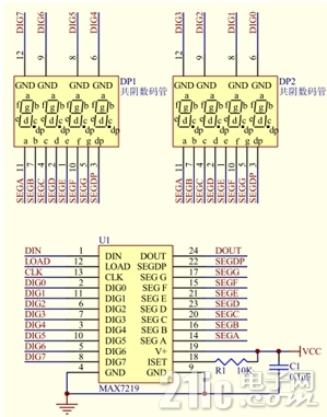

串行数码管显示模块的电路原理图见图2所示,该模块采用5V电压来工作。
图2 原理图

Max7219字节数据发送函数为:
  1. void Write_Max7219_byte(unsigned char DATA)
  3.       unsigned char i;
  4.       GPIO_ClearOutBits(HT_GPIOA, GPIO_PIN_4);
  5.            __Delay(10);
  6.       for(i=8;i>=1;i--)
  7.       {
  8.            GPIO_ClearOutBits(HT_GPIOA, GPIO_PIN_2);
  9.            if(DATA&0x80)  GPIO_SetOutBits(HT_GPIOA, GPIO_PIN_3);
  10.            else  GPIO_ClearOutBits(HT_GPIOA, GPIO_PIN_3);
  11.            __Delay(10);
  12.                       DATA=DATA<<1;
  13.            GPIO_SetOutBits(HT_GPIOA, GPIO_PIN_2);
  14.            __Delay(10);
  15. }
  16. }
Max7219写寄存器函数为:
  1. void Write_Max7219(char address,char dat)
  3.       GPIO_ClearOutBits(HT_GPIOA, GPIO_PIN_4);
  4.       Write_Max7219_byte(address);
  5.       Write_Max7219_byte(dat);
  6.       GPIO_SetOutBits(HT_GPIOA, GPIO_PIN_4);
  7. }
Max7219初始化函数为:
  1. void Init_MAX7219(void)
  3.       Write_Max7219(0x09, 0xff);
  4.       Write_Max7219(0x0a, 0x03);
  5.       Write_Max7219(0x0b, 0x07);
  6.       Write_Max7219(0x0c, 0x01);
  7.       Write_Max7219(0x0f, 0x01);
  8. }
主程序为:
  1. int main(void)
  3.   NVIC_Configuration();
  4.   CKCU_Configuration();
  5.   GPIO_Configuration();
  6.   RETARGET_Configuration();
  7.   T1_GPIO_Configuration();
  8.   Init_MAX7219();
  9.   __Delay(1000000);
  10.   Write_Max7219(0x0f, 0x00);
  11.   Write_Max7219(1,8);
  12.   Write_Max7219(2,7);
  13.   Write_Max7219(3,6);
  14.   Write_Max7219(4,5);
  15.   Write_Max7219(5,4);
  16.   Write_Max7219(6,3);
  17.   Write_Max7219(7,2);
  18.   Write_Max7219(8,1);
  19.   while (1)
  20.   {
  21.    ;
  22.   }
  23. }
