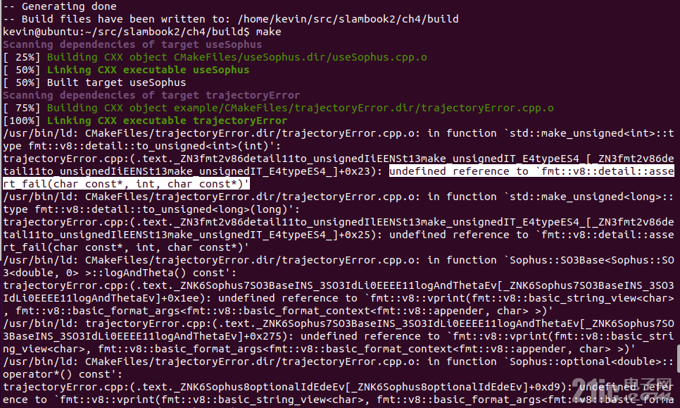

ch4是李群应用的章节,编译出现问题:
解决方法:
修改CMakeLists.txt
  1. cmake_minimum_required(VERSION 3.0)
  2. project(useSophus)
  3. # 为使用 sophus,需要使用find_package命令找到它
  4. find_package(Sophus REQUIRED)
  5. add_compile_options(-fPIC)
  6. set(FMT_LIBRARIES fmt::fmt)
  7. # Eigen
  8. include_directories("/usr/include/eigen3")
  9. add_executable(useSophus useSophus.cpp)
  10. # target_link_libraries(useSophus Sophus::Sophus)
  11. target_link_libraries(useSophus Sophus::Sophus fmt)
  12. # target_link_libraries(trajectoryError ${Pangolin_LIBRARIES} ${FMT_LIBRARIES} fmt)
