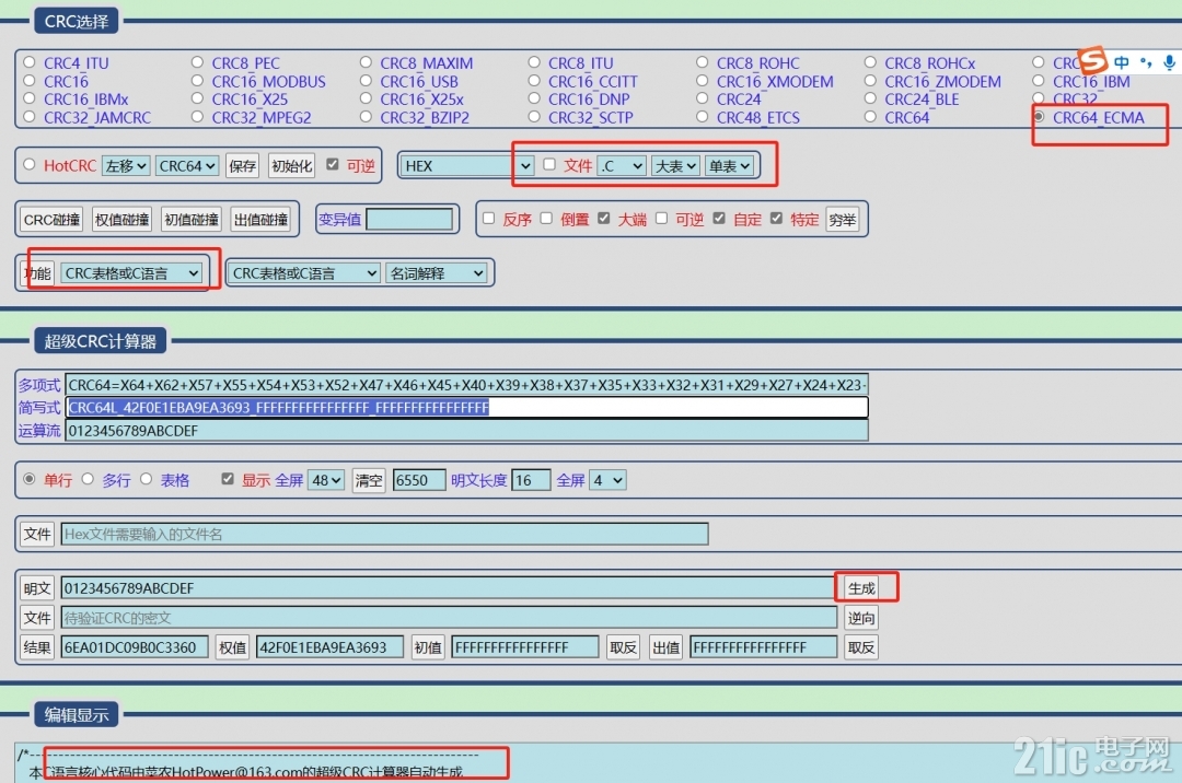

- HotCRC CRC64L_42F0E1EBA9EA3693_FFFFFFFFFFFFFFFF_0000000000000000 FPGA模块 HotPower[url=home.php?mod=space&uid=516618]@163.com[/url] 2023-09-21 12:17:07
