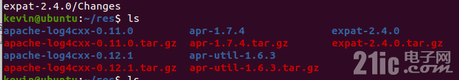

实践:
从以下地址下载代码:
  1. https://logging.apache.org/log4cxx/latest_stable/download.html
  2. https://apr.apache.org/download.cgi
  3. https://github.com/libexpat/libexpat/releases
 楼主| keer_zu 发表于 2024-4-25 14:19 | 显示全部楼层
先使用大约2021年的版本
 楼主| keer_zu 发表于 2024-4-25 15:07 | 显示全部楼层
compile apr:
  1. ./configure --host=aarch64-unknown-nto-qnx7.1.0 --prefix=/home/kevin/res/apr CC=/home/kevin/qnx710/host/linux/x86_64/usr/bin/aarch64-unknown-nto-qnx7.1.0-gcc  ac_cv_file__dev_zero=yes ac_cv_func_setpgrp_void=yes apr_cv_process_shared_works=yes apr_cv_mutex_robust_shared=yes apr_cv_tcp_nodelay_with_cork=yes ap_void_ptr_lt_long=no  apr_cv_tcp_nodelay_with_cork=yes
 楼主| keer_zu 发表于 2024-4-25 15:30 | 显示全部楼层
compile expat:
  1. ./configure --host=aarch64-unknown-nto-qnx7.1.0 --prefix=/home/kevin/res/expat CC=/home/kevin/qnx710/host/linux/x86_64/usr/bin/aarch64-unknown-nto-qnx7.1.0-gcc
 楼主| keer_zu 发表于 2024-4-25 15:52 | 显示全部楼层
compile log4cxx:
  1. ./configure --host=aarch64-unknown-nto-qnx7.1.0 --prefix=/home/kevin/res/log4cxx CC=/home/kevin/qnx710/host/linux/x86_64/usr/bin/aarch64-unknown-nto-qnx7.1.0-gcc CXX=/home/kevin/qnx710/host/linux/x86_64/usr/bin/aarch64-unknown-nto-qnx7.1.0-g++  --with-apr=/home/kevin/res/apr  --with-apr-util=/home/kevin/res/apr-util  --with-odbc=/home/kevin/res/unixODBC
