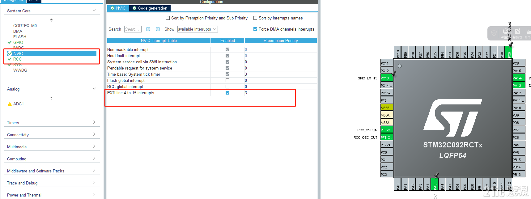

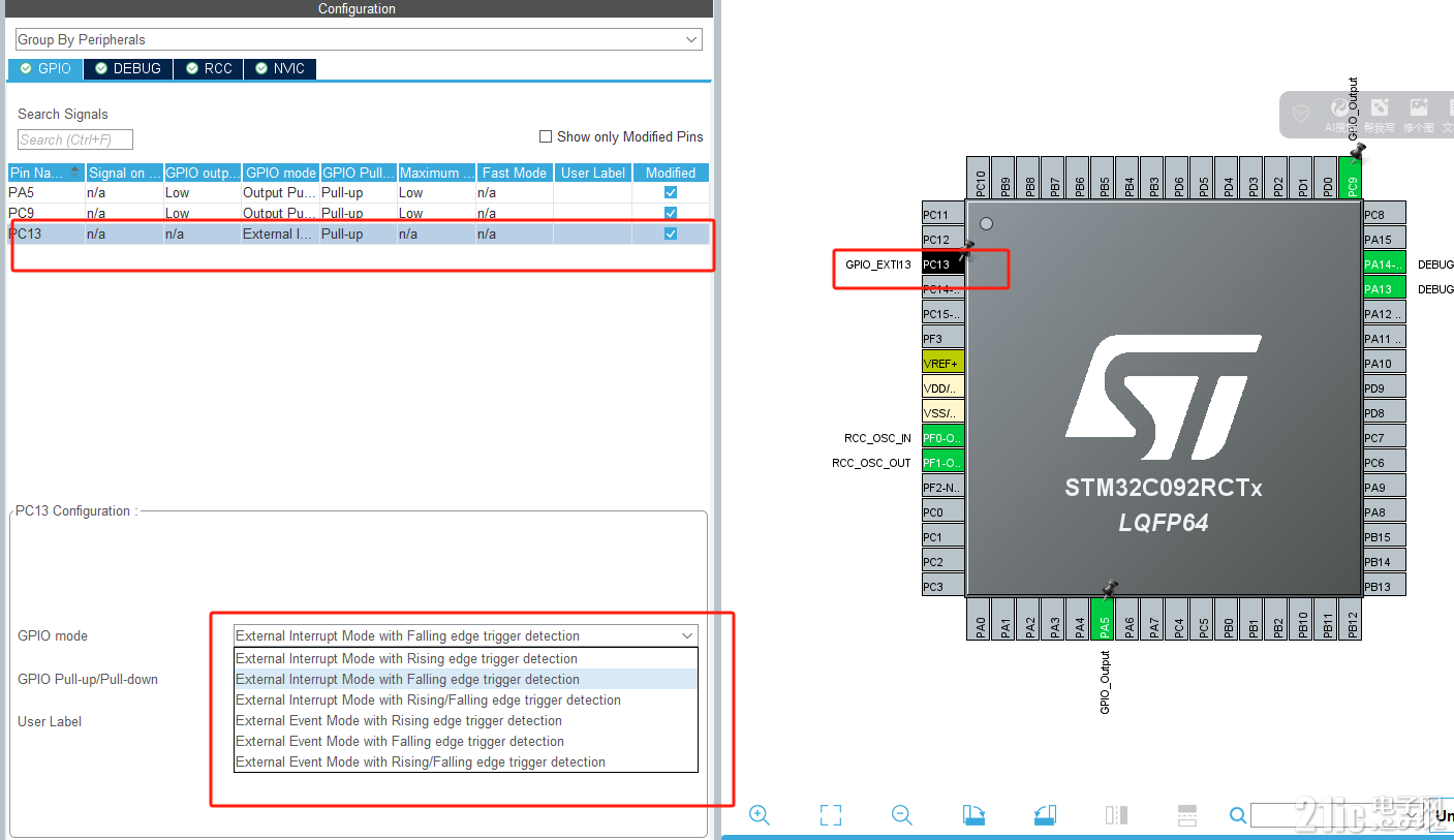

四:STM32cube MX 软件配置如下:
如上图所示:注意配置中断的触发模式:上升沿、下降沿或者是边沿触发,然后使能中断,并且配置中断13的优先级

GPIO13配置位下降沿触发,初始化配置成上拉模式
  1.   GPIO_InitStruct.Pin = GPIO_PIN_13;
  2.   GPIO_InitStruct.Mode = GPIO_MODE_IT_FALLING;
  3.   GPIO_InitStruct.Pull = GPIO_PULLUP;
  4.   HAL_GPIO_Init(GPIOC, &GPIO_InitStruct);
使能中断13的优先级
  1.   HAL_NVIC_SetPriority(EXTI4_15_IRQn, 3, 0);
  2.   HAL_NVIC_EnableIRQ(EXTI4_15_IRQn);
