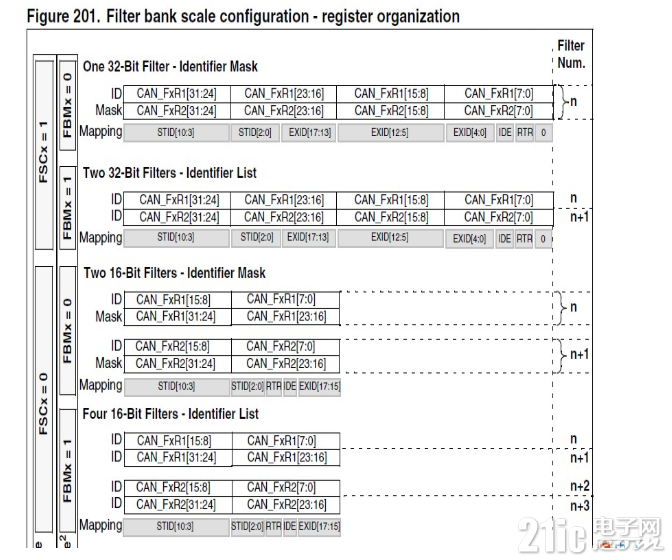

stm32的屏蔽滤波功能对ID是有要求的,mpc2515你可以直接写ID,但在STM32 这里ID必须进行移位处理.
 楼主| 过期的塔头 发表于 2021-7-23 23:34 | 显示全部楼层
对照下表: 8539860fae16d6245c.png

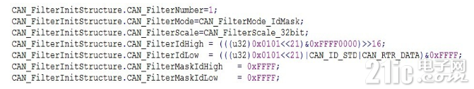

Standard Id滤波器设置: 4583560fae1a44fd54.png
 楼主| 过期的塔头 发表于 2021-7-23 23:36 | 显示全部楼层
CAN_FilterMaskId 位的含义是
Mask
Each bit of the register specifies whether the bit of the associated identifier register must
match with the corresponding bit of the expected identifier or not.
0: Don’t care, the bit is not used for the comparison
1: Must match, the bit of the incoming identifier must have the same level has specified in
the corresponding identifier register of the filter.
我们这里全部设置成1 ,也就是只接受CAN_Filter中设置的节点的数据
