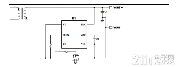

DESCRIPTION
The ZCC6908HV is a Low-Drop Diode Emulator IC that, combined with an external
switch, replaces Schottky diodes in high-efficiency Flyback converters. The chip
regulates the forward drop of an external Synchronous Rectifier (SR) MOSFET to
about 40mV and switches it off as soon as the voltage becomes negative. ZCC6908HV
can generate its own supply voltage for battery charging applications with low output
voltage or high side rectification applications. A programmable ringing detection
circuitry prevents ZCC6908HV false turn-on during DCM and Quasi-Resonant
operations.
ZCC6908HV is available in space saving TSOT23-6 packages.
FEATURES
● Operates in a wide output voltage range down to 0V
● Self-supplying for operation with low output voltage
rectification without an auxiliary winding
●· Works with 12V Standard and 5V Logic Level SR MOSFETS
●· Compatible with Energy Star, 1W Standby Requirements
●· <30ns Fast Turn-off and Turn-on Delay
●· <100uA Quiescent Current
●· Supports DCM, Quasi-Resonant and CCM Operations
●· Supports both High-side and Low-side Rectification
●· Power Savings of Up to 1.5W in a Typical Notebook Adapter
●· TSOT23-6 Package Available
APPLICATIONS
Industrial Power Systems
Distributed Power Systems
Battery Powered Systems
Flyback Converters
