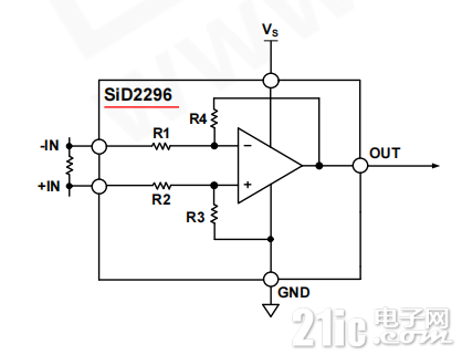

Features
SMALL VOLTAGE OFFSET:
 SiD2296: ±0.5mV (MAX)
WIDE COMMON MODE VOLTAGE:
SiD2296: -0.1V to +85V
±0.5% Gain Error (Max, -40°C ~125°C)
0.6μV/°C Offset Drift (Max, -40°C ~125°C)
WIDE CMRR THROUGH COMMON VOLTAGE: 100dB
SUPPLY VOLTAGE: 3.0V to +18V
ACCURACY and ZERO-DRIFT PERFORMANCE
 5ppm/°C Gain Drift (Max, -40°C ~125°C)
THREE GAIN OPTIONS for VOLTAGE OUTPUT
SiD2296T: 20V/V
SiD2296F: 50V/V
SiD2296H: 100V/V
Description
The SiD2296 family is of high voltage, high side current sense
amplifier with voltage output. The SiD2296 can sense drops
across shunts at common-mode voltages from –0.1V up to 85
V. The SiD2296 are available with three output voltage scales:
20V/V, 50V/V, 100V/V, with up to 0.5MHz bandwidth.
The SiD2296 operates from single 3.0V to 18V supply, offers
breakthrough performance throughout the −40°C to +125°C
temperature range. It features a zero-drift core, which leads to
an offset drift of 0.6μV/°C throughout the operating temperature
range and the common-mode voltage range.
The SiD2296 is offered in 6-pin and 5-pin SOT23 package.
