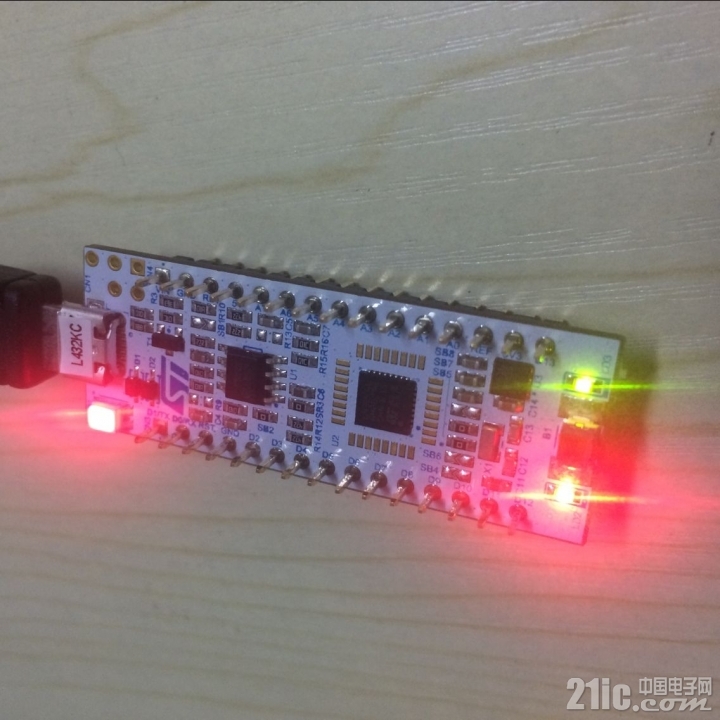

*非常荣幸收到来自21ic寄发的Nuleo  STM32L432KC,  最新Nucleo 32系列的低功耗的L4样品。废话不多说,先上个靓照。(i5s的像素有点渣,将就一下)
-->ST一如既往的包装风格。

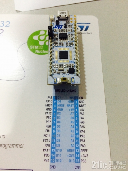

-->这是正面图,卡片还有IO的定义,非常贴心,哪里不会看哪里。
-->这是底面图,整个板子非常地简洁小巧可爱有没有。

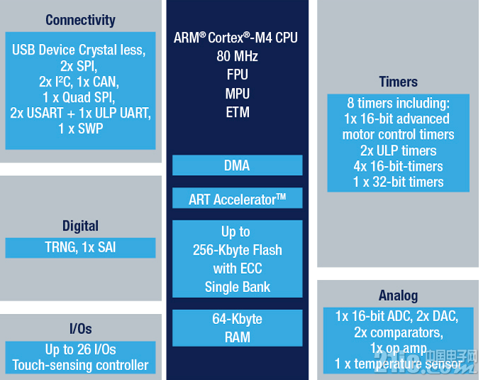

再来看下STM32L432KC这款低功耗芯片的主要特性:
  • Ultra-low-power with FlexPowerControl
    • 1.71 V to 3.6 V power supply
    • -40 °C to 85/105/125 °C temperature range
    • 8 nA Shutdown mode (2 wakeup pins)
    • 28 nA Standby mode (2 wakeup pins)
    • 280 nA Standby mode with RTC
    • 1.0 μA Stop 2 mode, 1.28 μA Stop 2 with RTC
    • 84 μA/MHz run mode
    • Batch acquisition mode (BAM)
    • 4 μs wakeup from Stop mode
    • Brown out reset (BOR) in all modes except shutdown
    • Interconnect matrix
  • Core: ARM® 32-bit Cortex®-M4 CPU with FPU, Adaptive real-time accelerator (ART Accelerator™) allowing 0-wait-state execution from Flash memory, frequency up to 80 MHz, MPU, 100DMIPS/1.25DMIPS/MHz (Dhrystone 2.1), and DSP instructions
  • Performance Benchmark
    • 1.25 DMIPS/MHz (Drystone 2.1)
    • 273.55 Coremark® (3.42 Coremark/MHz @ 80 MHz)
  • Energy Benchmark
    • 176.7 ULPBench® score
  • Clock Sources
    • 32 kHz crystal oscillator for RTC (LSE)
    • Internal 16 MHz factory-trimmed RC (±1%)
    • Internal low-power 32 kHz RC (±5%)
    • Internal multispeed 100 kHz to 48 MHz oscillator, auto-trimmed by LSE (better than ±0.25 % accuracy)
    • Internal 48 MHz with clock recovery
    • 2 PLLs for system clock, USB, audio, ADC
  • RTC with HW calendar, alarms and calibration
  • Up to 3 capacitive sensing channels
  • 11x timers: 1x 16-bit advanced motor-control, 1x 32-bit and 2x 16-bit general purpose, 2x 16-bit basic, 2x low-power 16-bit timers (available in Stop mode), 2x watchdogs, SysTick timer
  • Up to 26 fast I/Os, most 5 V-tolerant
  • Memories
    • Up to 256 KB single bank Flash, proprietary code readout protection
    • 64 KB of SRAM including 16 KB with hardware parity check
    • Quad SPI memory interface
  • Rich analog peripherals (independent supply)
    • 1× 12-bit ADC 5 Msps, up to 16-bit with hardware oversampling, 200 μA/Msps
    • 2x 12-bit DAC, low-power sample and hold
    • 1x operational amplifier with built-in PGA
    • 2x ultra-low-power comparators
  • 13x communication interfaces
    • USB 2.0 full-speed crystal less solution with LPM and BCD
    • 1x SAI (serial audio interface)
    • 2x I2C FM+(1 Mbit/s), SMBus/PMBus
    • 3x USARTs (ISO 7816, LIN, IrDA, modem)
    • 2x SPIs (3x SPIs with the Quad SPI)
    • CAN (2.0B Active)
    • SWPMI single wire protocol master I/F
    • IRTIM (Infrared interface)
  • 14-channel DMA controller
  • True random number generator
  • CRC calculation unit, 96-bit unique ID
  • Development support: serial wire debug (SWD), JTAG, Embedded Trace Macrocell™

-->上电前讲D2与相邻的GND通过短路帽相连,当与PC相连时可以看到LD1(USB communication)与LED2( power LED) 常亮红色,LED3(user LED)常闪烁绿色。

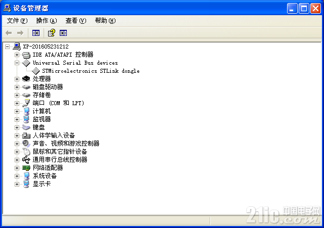

-->电脑可以看到可移动设备弹出,因为我的电脑没有装过ST-link的驱动,所以这里还得装下ST-link的驱动,为了后面的下载调试。
    ST-link的驱动可以在ST官网下载http://www.st.com/content/st_com/en/products/embedded-software/development-tool-software/stsw-link009.html
但不知道为何,我从ST官网下载的这个驱动
我的win7-64bit 系统竟然安装不了!!!这个到是让我特别郁闷。。
7.png -------------------------------------------------------------------------------------------------------------------------------------------------------------------------------------
今天在公司连接到xp系统,官网的 STSW-LINK009 驱动包可以安装,但仍然出现如下问题,这不清楚是这个安装包的问题还是我测试的两个系统有点问题。
在群友的提示下,下载了并安装了STVP工具:http://www.st.com/content/st_com/zh/products/development-tools/software-development-tools/stm32-software-development-tools/stm32-programmers/stvp-stm32.html?dl=qpZrYwNzqQrmjPRKha0MMA%3D%3D%2CRGKCNJh%2FUvEnmj2%2BZdKBroeb5Qy%2BsgelH4JQt0l813F81ori1wFPh8whxVo%2FYyKO
如果出现和我一样的情况,可以尝试这个方法。

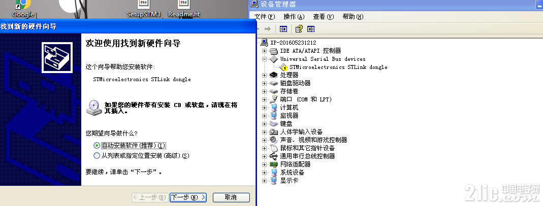

-->安装
-->重新和评估板相连,选择自动安装,安装完成提示要求重启,重启完成后可能还会出现下图提示,继续自动安装,
-->完成,可以使用了,昨晚郁闷了一晚上的事情总算解决了,但现在郁闷的是为什么那个STSW-LINK009 驱动包为什么不行还有待研究。

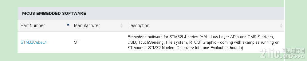

-->在ST官网下载相应的例程:http://www.st.com/content/st_com/zh/products/evaluation-tools/product-evaluation-tools/mcu-eval-tools/stm32-mcu-eval-tools/stm32-mcu-nucleo/nucleo-l432kc.html
当然,因为这是ST的新品,大家熟悉的keil也要使用到MDK5版本:
http://www.keil.com/dd2/Pack/#/eula-container
这里附上的是MDK的各种 sooftware pack,找到STML4系列的并下载安装。

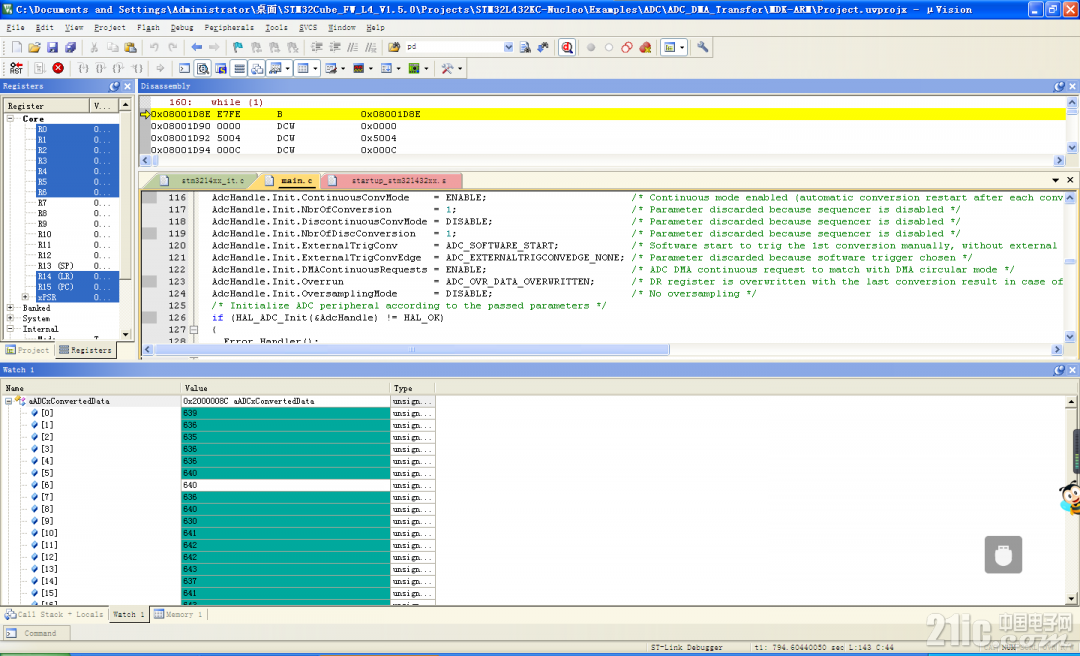

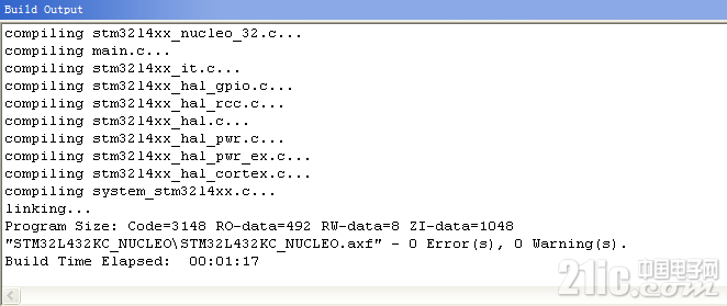

-->试试ADC的例程,找到ADC_DMA_Transfer文件夹,打开工程并编译:
-->点击仿真,全速运行,LED1红绿交替闪烁。

lonesmile 发表于 2016-8-11 10:29 | 显示全部楼层
请问楼主 那里我怎么没有找到例程呢  求指点
joketinnle 发表于 2016-8-11 11:17 | 显示全部楼层
STM32CubeMX
 楼主| minDragon 发表于 2016-8-11 11:38 | 显示全部楼层
lonesmile 发表于 2016-8-11 12:23 | 显示全部楼层
你在链接的网页找到这个点进去。里面有Cubemax软件和L4的例程下载
已找到 谢谢了
lonesmile 发表于 2016-8-11 12:38 | 显示全部楼层
请问 那个驱动已经装了STVP了 为什么还是没有显示驱动呢  连接板子时 看也没有
 楼主| minDragon 发表于 2016-8-11 14:04 | 显示全部楼层
请问 那个驱动已经装了STVP了 为什么还是没有显示驱动呢  连接板子时 看也没有 ...
目测你的COM3已经连接上了。你电脑还有接其他STlink吗?如果没有直接用keil试试看能不能识别到你的板子。
lonesmile 发表于 2016-8-11 14:18 | 显示全部楼层
目测你的COM3已经连接上了。你电脑还有接其他STlink吗?如果没有直接用keil试试看能不能识别到你的板子。 ...
没法识别呀  对了 我用的是WIN10
 楼主| minDragon 发表于 2016-8-11 14:34 | 显示全部楼层
没法识别呀  对了 我用的是WIN10
win10我倒没试过,你换个USB口试试。ST的那些驱动你都试试看行不行。
