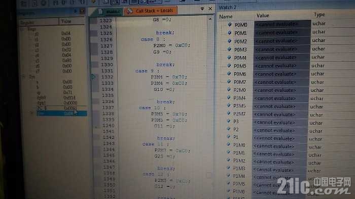

P3_4 P3_5重设模式,程序跑数分鐘後,程序當掉,如附图PC=0x0001,有时Keil c51也當掉,如何迴避这问题?

应该是连接有中断吧

Now it is solved, interfered by UART ISR which is empty
