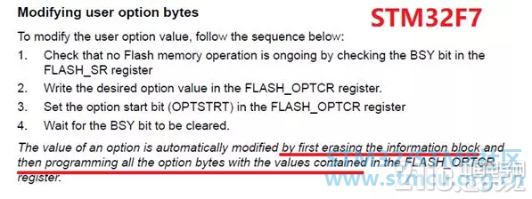

[STM32F7] STM32F767 读保护问题
 楼主| fubeining 发表于 2020-3-23 16:52 | 显示全部楼层 |阅读模式
FLASH_OBProgramInitTypeDef obProgram;
        __HAL_FLASH_PREFETCH_BUFFER_DISABLE();
        HAL_FLASHEx_OBGetConfig(&obProgram);
        if (obProgram.RDPLevel == OB_RDP_LEVEL_0){
                obProgram.OptionType = OPTIONBYTE_RDP;        //读保护
                obProgram.RDPLevel = OB_RDP_LEVEL_1;
                obProgram.BORLevel = OB_BOR_LEVEL3;                //Supply voltage ranges from 2.70 to 3.60 V
                HAL_FLASH_Unlock();
                HAL_FLASH_OB_Unlock();
                HAL_FLASHEx_OBProgram(&obProgram);                //此处返回成功
                HAL_FLASH_OB_Lock();
                HAL_FLASH_Lock();
        __HAL_FLASH_PREFETCH_BUFFER_ENABLE();
                return;
HAL_FLASHEx_OBProgram() 函数操作成功 但没实际生效  并没有写入  请问各位什么问题?

ccbv126 发表于 2020-5-20 10:46 | 显示全部楼层
少了HAL_FLASH_OB_Launch();//设置进去没有加载,所以是无效的。
dongnanxibei 发表于 2020-5-20 23:37 | 显示全部楼层
应该看看所有相关库函数,看看少了哪个。
