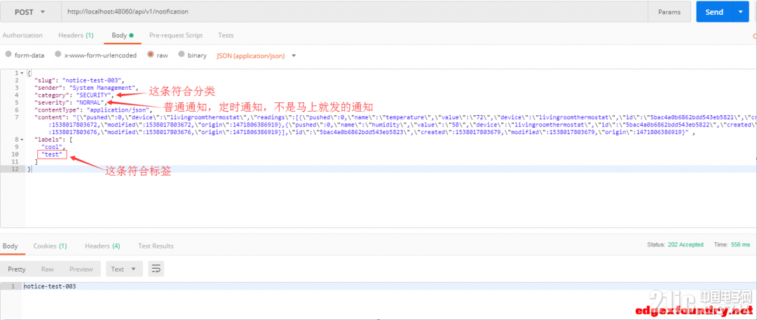

   2、手工生成通知
   POST TO http://localhost:48060/api/v1/notification
   (会保存在notifications 数据库notifications表中)
   2.1 restful格式
     "slug": "notice-test-003",
     "sender": "System Management",
     "category": "SECURITY",
     "severity": "NORMAL",
     "contentType": "application/json",
     "content": "{\"pushed\":0,\"device\":\"livingroomthermostat\",\"readings\":[{\"pushed\":0,\"name\":\"temperature\",\"value\":\"72\",\"device\":\"livingroomthermostat\",\"id\":\"5bac4a0b6862bdd543eb5821\",\"created\":1538017803672,\"modified\":1538017803672,\"origin\":1471806386919},{\"pushed\":0,\"name\":\"humidity\",\"value\":\"58\",\"device\":\"livingroomthermostat\",\"id\":\"5bac4a0b6862bdd543eb5822\",\"created\":1538017803676,\"modified\":1538017803676,\"origin\":1471806386919}],\"id\":\"5bac4a0b6862bdd543eb5823\",\"created\":1538017803679,\"modified\":1538017803679,\"origin\":1471806386919}" ,
     "labels": [
       "cool",
       "test"
   postman工具提交:
通知结果:
