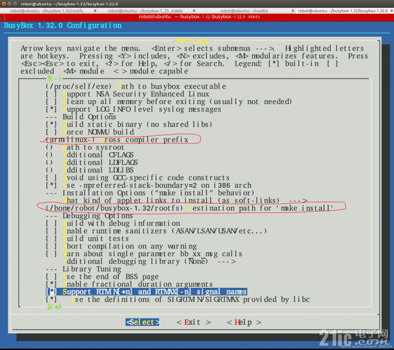

1.2).配置busybox
make menuconfig
需选择配置内容:
a).—Build Options
Cross compiler prefix
arm-linux-
b).—Installation Options (“make install” behavior)
Destination path for ‘make install’
/home/robot/busybox-1.32/rootfs /* path /
c).
Coreutils—>
[ ] sync (3.8 kb) / cancel /
d).
Linux System Utilities—>
[ ] nsenter (6.5 kb) / cancel */
1.3).编译安装
make
make install //注意 make install 配置路径
