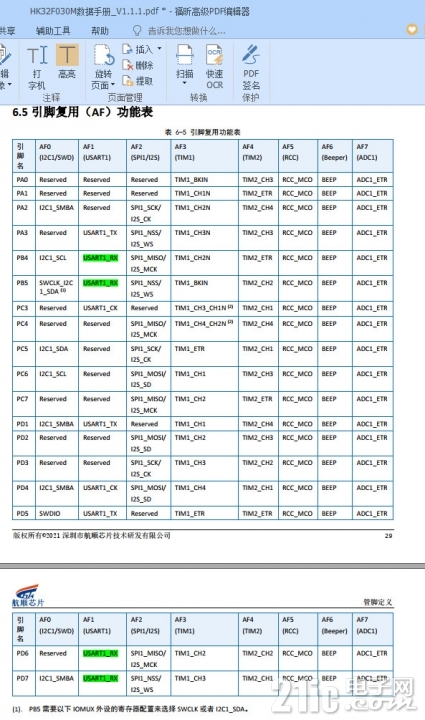

 楼主| 明翰的帅爸爸 发表于 2021-8-27 11:24 | 显示全部楼层 |阅读模式
在官方例程上直接修改这两个地方,将PD6改为PD2
static void USART_GPIO_Configurature(void)
        GPIO_InitTypeDef m_gpio;
        USART1_TX_IO_CLK_EN();
        RCC_AHBPeriphClockCmd(RCC_AHBPeriph_GPIOD, ENABLE);
    RCC_APB2PeriphClockCmd(RCC_APB2Periph_USART1, ENABLE);
    RCC_APB2PeriphClockCmd(RCC_APB2Periph_SYSCFG, ENABLE);
    RCC_APB1PeriphClockCmd(RCC_APB1Periph_IOMUX, ENABLE);
        m_gpio.GPIO_Mode = GPIO_Mode_AF;
        m_gpio.GPIO_OType = GPIO_OType_PP;
        m_gpio.GPIO_Pin = USART1_TX_PIN;
        m_gpio.GPIO_PuPd = GPIO_PuPd_NOPULL;
        m_gpio.GPIO_Speed = GPIO_Speed_50MHz;
        GPIO_Init(USART1_TX_PORT, &m_gpio);
        GPIO_PinAFConfig(USART1_TX_PORT, GPIO_PinSource3, GPIO_AF_1);
        m_gpio.GPIO_Pin = GPIO_Pin_2;
        GPIO_Init(GPIOD, &m_gpio);
        GPIO_PinAFConfig(GPIOD, GPIO_PinSource2, GPIO_AF_1);
发现不能进入接收中断,试了PD1/3/4也不行,改回GPIO_Pin_6和GPIO_PinSource6又可以了
求各位大佬帮忙看看

ifxz0123 发表于 2021-8-27 16:01 | 显示全部楼层
 楼主| 明翰的帅爸爸 发表于 2021-8-27 16:20 | 显示全部楼层
看数据手册中关于引脚复用说明,PB4、PB5、PD6、PD7都可以复用为USART1_RX
感谢大佬
我现在板子RX接的是PD2,只能用软件模拟串口了,下一版再改
